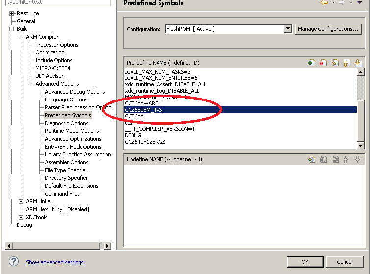

  • Hy Jerry,
    did you finally get it running? Having the same issues at the moment.
    > There is #define CC2650EM_4XS in board.h but not work.
    You probably need to define the symbol in project settings rather than typing a define to the header:
    But I don't have it running yet, either.
    Harald
  • Harald,
    There are 3 things that should be necessary here to modify in SimpleBLEPeripheral
    1: Modify compiler search path to ensure #include <board.h> will find your custom board.h. This is done in the application properties under Build->ARM Compiler->Include Options->"${TI_RTOS_DRIVERS_BASE}/ti/boards/SRF06EB/CC2650EM_7ID"
    2: Ensure CC2650EM_4XS is defined either in your board.h file or as a predefined symbol. In main.c this file is included before bleUserConfig.h which builds up the RF configuration for the stack.
    3: Remove the compiler preprocessor symbols TI_DRIVERS_SPI_DMA_INCLUDED and TI_DRIVERS_LCD_INCLUDED. The 4x4 EM does not have enough pins available to use the LCD.
    Once you have re-built the project:
    - Check that the correct Board.h file is included in main.c by right-clicking "Board.h" and select "Open declaration"
    - Open bleUserConfig.h and find the structure BLE_USER_CFG. Do the same with the symbol RF_FE_MODE_AND_BIAS to check it has compiled in the version for CC2650EM_4XS.
    .:svend

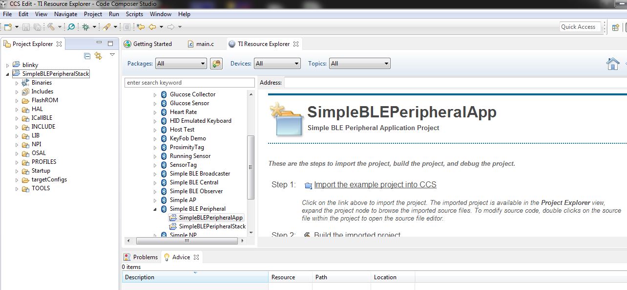

  • Hello, svend.
        I also meet this the problem. I have followed  your steps as above.But I can understand how to check the  BLE_USER_CFG. Could you please tell me how to do it?
    Thank you very much.
  • Expand SimpleBLEPeripheral in CCS. Expand Startup. Expand main.c Right click bleUserConfig.h select open. In main.c this file will be highlighted. Right click and open declaration, it will open the file in CCS for editing.
