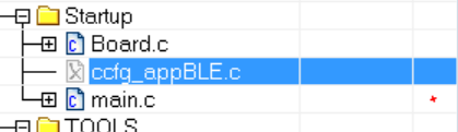

    This sounds like you are missing CCFG ($CC26XXWARE\startup_files\ccfg.c) in your application. If this is not compiled in then the linker will have nothing to place here. For example in IAR, this is done by the following linker file directive:
    place at end of FLASH_region { readonly section .ccfg };
    What happens is that the Boot ROM will check for flash image being valid in CCFG (==0x0) and if not, branch to the bootloader. The debugger will then move you to e.g. __iar_program_start anyway and the application -seems- to be working but have skipped device initialization in the reset ISR. This can cause e.g. issues with 24Mhz XTAL startup.

  • You were absolutely right. Unsure how this happened but I have somehow excluded file which includes it:
