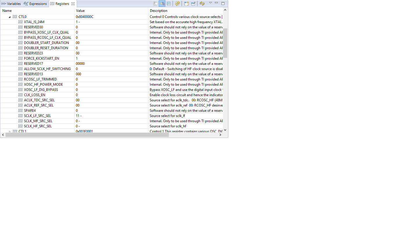

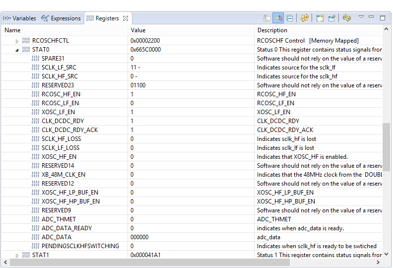

  • Seeing advertisments but not being able to connect with our default projects -can- indicate that timing is way off.
    This can happen if your external 32.768kHz crystal fails to start up and the LF clock used for the RTC is kept at its reset value (48MHz from HF RCOSC / 1536 = 31.25kHz).
    You can try to set a breakpoint in main() and check the register values of the oscillator module control and status registers.
    They are found in register view at the module DDI_0_OSC and registers CTL0:SCLK_LF_SRC_SEL and STAT0:SCLK_LF_SRC.

  • Hi Svend,
    Thank you very much for your interest and your quick answer.
    We've checked the register values you pointed, but the results seem to discard the cause you mentioned, since we found the following:
    •   CTL0:SCLK_LF_SRC_SEL: "11 -" (xosc_lf_clk Low frequency XOSC)
    •   STAT0:SCLK_LF_SRC: "11 -" (xosc_lf)
    Also:
    •   XOSC_LF_DIG_BYPASS: 0
    As shown in following captures:
