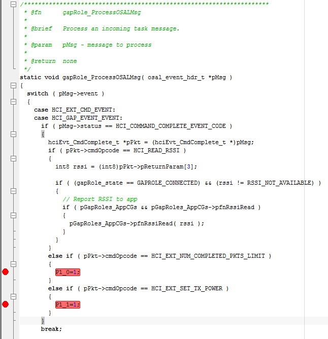

    Thanks for your reply,i really appreciate that.i am confused about your replay that "We do not have this documented for 1.4.0 and it is rather complicated".i can find this command in document:TI_BLE_Vendor_Specific_HCI_Guide in BLE Stack 1.4.0 installer. this command should be supported by BLE Stack 1.4.0? so i called this command in application.then i connect device,sent out some data.according to the say in TI_BLE_Vendor_Specific_HCI_Guide,"When  the  HCI_EXT_NumComplPktsLimitCmd  has  completed,  a  vendor  specific  Command Complete event shall be generated." but i did't recived that. below is my code.
    something i wrong? i also try the other HCI Extension Vendor Specific Commands. like:HCI_EXT_HaltDuringRfCmd(HCI_EXT_HALT_DURING_RF_DISABLE ), HCI_EXT_SetTxPowerCmd( LL_EXT_TX_POWER_4_DBM ),etc.i also did't recived the corresponding event in my code.could you show me example? thanks a lot.

  • The command is supported. There is no documentation for adding the ability to receive HCI Vendor specific events (such as num completed packet events) in the application.

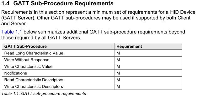

    PS:whether the indication (ATT / GATT procedure) can use in HIDEmuKbd project? in the HIDS_SPEC_V10,i can't find it.
    or are there projects based on HOGP and Indication ( GATT Sub-Procedure )?
