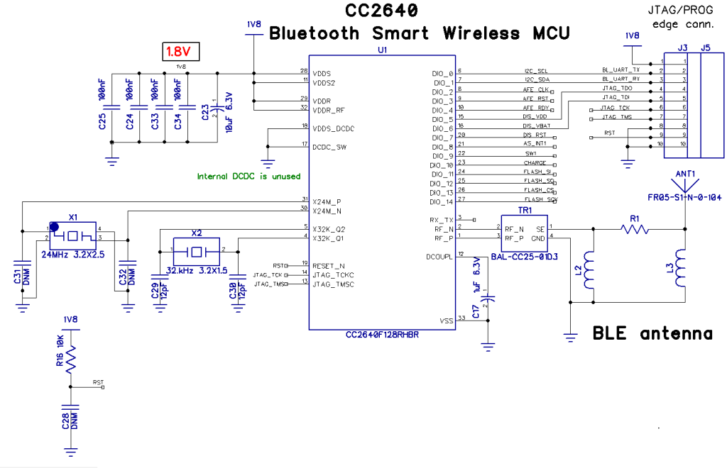

I'm trying to program a CC2640 (7x7) with an DevPack debugger. I'm using the devpack alone without the sensorTag.
I've connected the devpack to my PCB using the 4-wire JTAG interface: TMSC, TCKC, TDIO and TDO. Also, I've also tested with the nRESET.

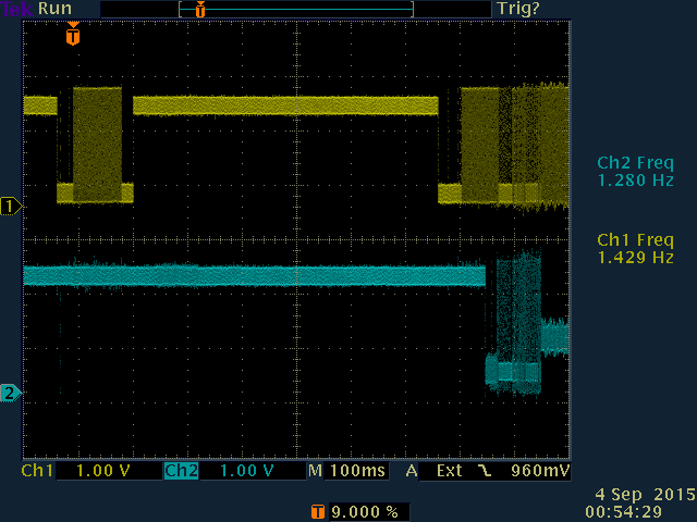

However, when I tried to program a project with the CCS I always obtain the same error:
Error connecting to the target:
(Error -2131 @ 0x0)
Unable to access device register. Reset the device, and retry the operation. If error persists, confirm configuration, power-cycle the board, and/or try more reliable JTAG settings (e.g. lower TCLK).
(Emulation package 6.0.14.0)

Do you know if it is possible to program a CC2640 with the devpack alone? It is necessary another connection between my board and the devpack?
