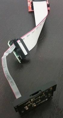

In order to connect the XDS100V3 to the SensorTag OR to a custom board we will be using the MDL-ADA2 10-pin to 20-pin JTAG Adapter Module. It can be bought from the TI Store, Mouser, DigiKey, etc.
Here is the schematic:
Connect the cable to the SensorTag here:
If you have your own custom board connect the cable to the 10-pin ARM Cortex JTAG connector on your board.
The full connection link should look like this (for SensorTag):
