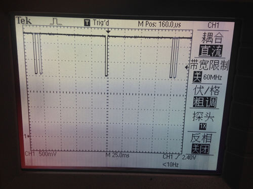

    The waveform of Vout of TPS62730 in is shown in the following photo, which is allright.

    Compare 1. and 2., I don't know why the SimpleBLEPeripherial example cannot work well with TPS62730 controlled with BLE stack, but good in KeyFob example. I think, considering 1., 3. and 4., it's unlikely a haredware problem.
