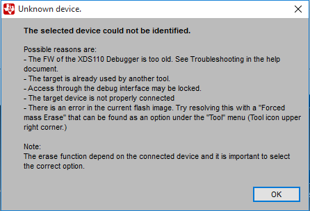

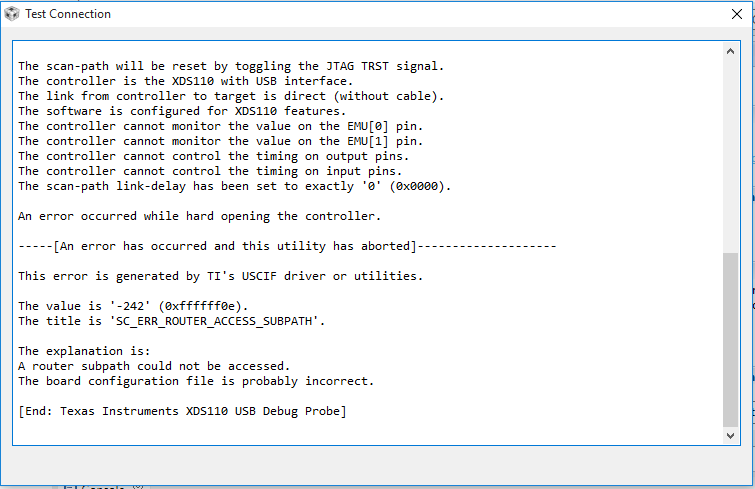

I am now under huge pressure to complete a project and have made no progress towards being able to program the chip. I have a custom board with the 7x7mm CC2640 on it. I have also used the TPS3705 to monitor voltage levels and handle reset. When I connected the CC-DEVPACK-DEBUG to the board I was encountered with multiple different errors for example:
I didn't manage to screenshot them all before the chip died on its own (will get back to that). I have tried the following
  • Windows 10 and 7
  • Latest and older versions of CCS
  • Updated the XDS Emulation Software Package
  • Ran xdsdfu and updated firmware
  • Uninstall and reinstall everything including drivers
I tried SmartRF Flash Programmer 2, it sees the following:
1) Please suggest where I should go from here.

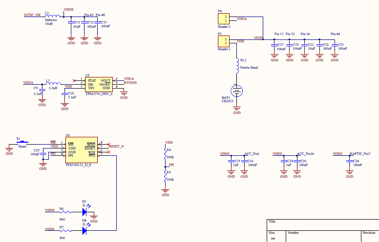

As I understand it, this is correct. The manual reset on the TPS3705 worked no problem as well. The only issue I see being possible is that instead of the resistor and cap on the reset pin, I connected the debugger reset to the manual reset of the TPS3705.
2) Could this be causing the debugger errors?
Please have a look at my schematic and layout below:

  • Maybe i am overlooking something obvious, but i cannot see the reset line on the 10pin ARM JTAG header.
  • I connected the JTAG reset to the manual reset of the TPS3705. The manual reset works but i was concerned there would be a delay.

    For debugging you need to connect the reset directly to the CC2640 reset. However it should still be recognized in SmartRF Flash Programmer 2 I think. What is the reason for having the external POR circuit on the board? The CC2650 contains a built-in power-on-reset, brown-out circuit s and a watchdog already.
    Have you also monitored the reset signal from the TPS3705 with a scope to ensure it does not toggle occasionally?
    Svend

  • I don't quite understand the statement "manual reset works"? As far as i always thought is that the JTAG XDS programers need to be able to control the reset line for correct timing of debug signals after reset. Your schematic does not show that the reset pin from the CC26xx is connected to the debug header. It's the first thing i would correct. I see you have the reset brought out as a TP so that should be an easy fix.
  • The TPS370 has a Manual Reset pin, i connected the JTAG reset to this. When pulled low it pulls the reset pin on the CC2640 low.  I should not have done it this way as it simply adds another  "moving part". Will be sure to bypass it before trying anything else.  Thanks
  • It was TPS370... It was somehow affecting both the power supply and the debugging. Maybe a faulty chip, not sure. Either way, wasn't a good idea to try connect the debug reset through it.
  • I'm glad you figured it out. It was the only part of your Schematic that looked like a potential culprit. Good luck.
