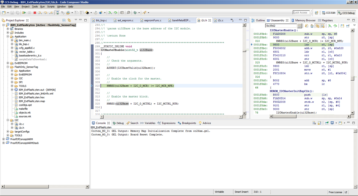

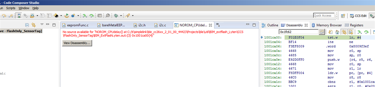

As soon as I jump into the function I2CMasterEnable, line
HWREG(ui32Base + I2C_O_MCR) |= I2C_MCR_MFE;
from I2CMasterInitExpClk, there is a jump to address 0x1001ca00 (which is not within my BIM range...) and then stops debugging

    You are correct in that you can't use RTOS drivers in the BIM; the BIM page is not large enough to accommodate an instance of the RTOS. You will need to directly access the I2C registers, using CC26XXWARE (driverLib) as an example. The default SPI flash should be an comparable example.
    It looks like you are hitting an HW exception. Have you configured the respective I2C pins accordingly? You'll need to explicitly do this in the BIM as the BIM is a standalone executable. Use the debugger to confirm the respective PIN mux is configured accordingly.
