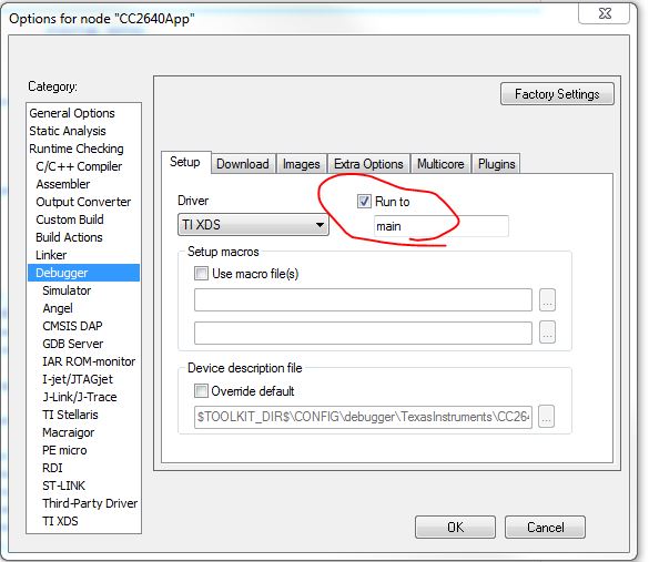

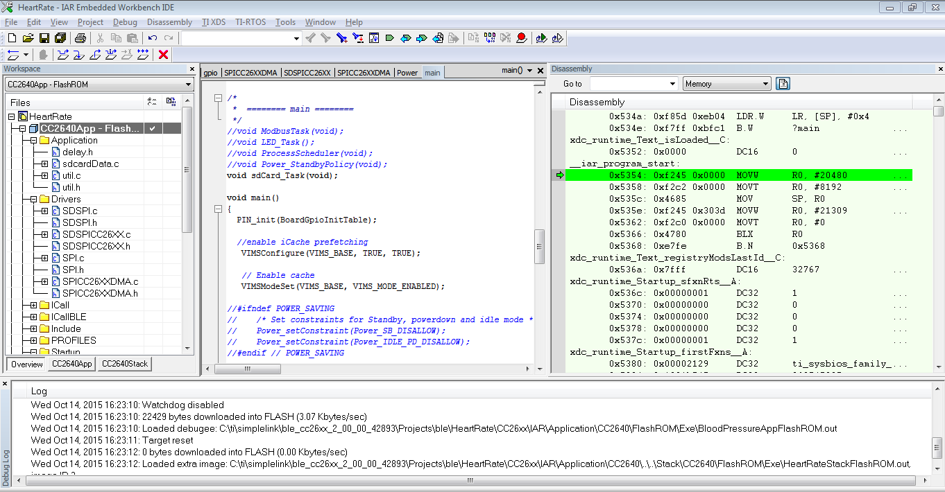

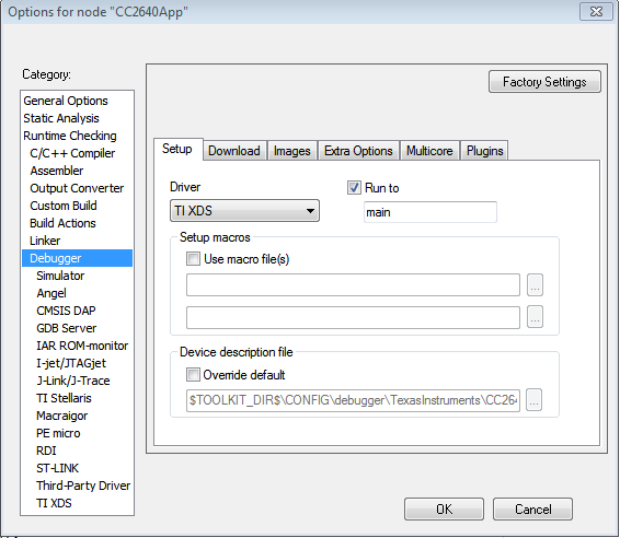

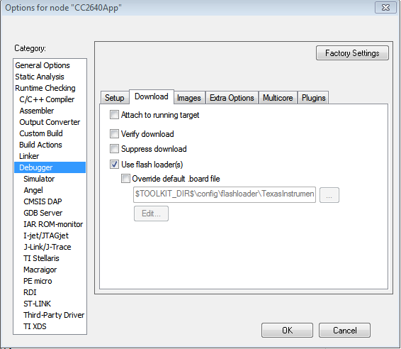

I have check debugging setting and try again download and debug program. But still same problem any other setting or changing needed for solving this problem
I don't know what i do. I think something changed in Linker or Debugger setting. Any way to get default setting or change in proper setting to solve this problem.
I don't know what i changed. I think in Linker and Debugger setting changed. Any way to get default setting or to change in proper setting to solve this problem

I am not sure why you can't go to main even with that check box selected. Can you see device advertising? if the program running? Is it possible to re-install BLE stack?
