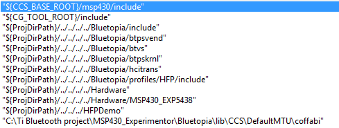

I believe the issue is an incompatible libmath.a ? how can I fix this?
I use the trial version of CCS 6 and have installed the MSP430 add-ins. The compiler version is TI v4.4.2 running COFF output format. Run-time support library is set to automatic. I have attached the list of the includes.
If I switch my compiler to eaib (ELF), I receive the following error (this happens even when I add an explicit "C:\ti\Connectivity\CC256X BT\CC256x MSP430 Bluetopia SDK\v1.5 R2\MSP430_Experimentor\Bluetopia\lib\CCS\DefaultMTU\eabi" to the include files ):

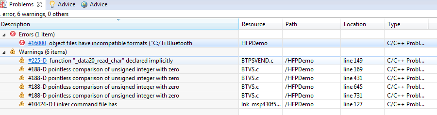

fatal error #16000: object files have incompatible formats ("C:/Ti Bluetooth
project/MSP430_Experimentor/Bluetopia/lib/CCS/DefaultMTU/coffabi/libBluetopi
a_SCO.a<BSC.obj>" = TI-COFF, "./BTPSKRNL.obj" = ELF)
>> Compilation failure
gmake: *** [HFPDemo.out] Error 1
gmake: Target `all' not remade because of errors.
**** Build Finished ****
I would really appreciate any help I can get on this.

    That is stranger, I have imported the Default HFP Demo which is part of the v1.5 R2 release and built it on CCS 6, it without any issues.
    I hope you have not changed any thing in the project.
    Please make sue the below two steps before building the project
    1. Just make sure that while importing the project, Make sure that the “Copy projects in to workspace” and “Automatically import Referenced projects found in same search-directory” options are unchecked (not selected).
    2. And after importing the project, Right click on the “HFPDemo project” -> “Build Configurations” -> “Set Active” -> and select “Debug – MSP43F5438A Exp (MSP430F5438A Experimenter Debug Build)”

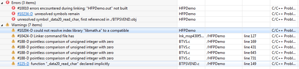

    warning #10204-D: could not resolve index library "libmath.a" to a compatible
    library
    undefined first referenced
    symbol in file
    _data20_read_char ./BTPSVEND.obj
    error #10234-D: unresolved symbols remain
    error #10010: errors encountered during linking; "HFPDemo.out" not built

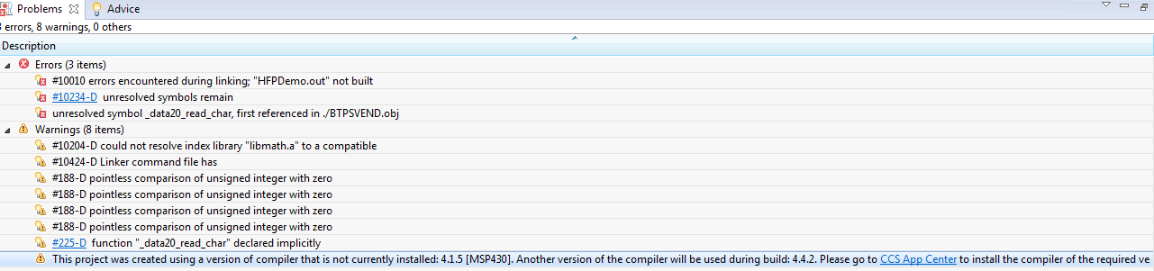

    It looks like you have modified the demo. Below is what I see while building which is different from what you are doing. The default demo should build without any issues. Try to reduce the coded size, It will work.
    "C:/TI/CCS6/ccsv6/tools/compiler/msp430_4.3.3/bin/cl430" -vmspx --abi=coffabi --code_model=large --data_model=small --near_data=globals -g --define=__MSP430F5438A__ --define=BTPS_MEMORY_BUFFER_SIZE=3250 --define=__SUPPORT_LOW_ENERGY__ --define=__DISABLE_SMCLK__ --diag_warning=225 --display_error_number --diag_suppress=172 --silicon_errata=CPU21 --silicon_errata=CPU22 --silicon_errata=CPU23 --silicon_errata=CPU40 --printf_support=minimal -z --stack_size=1200 -m"HFPDemo.map" --heap_size=0 --use_hw_mpy=F5 -i"C:/TI/CCS6/ccsv6/ccs_base/msp430/include" -i"C:/TI/CCS6/ccsv6/tools/compiler/msp430_4.3.3/lib" -i"C:/TI/CCS6/ccsv6/tools/compiler/msp430_4.3.3/include" -i"C:/TI/Connectivity/CC256X BT/CC256x MSP430 Bluetopia SDK/v1.5 R2_n/MSP430_Experimentor/Bluetopia/lib/CCS/DefaultMTU/coffabi" -i"C:/TI/Connectivity/CC256X BT/CC256x MSP430 Bluetopia SDK/v1.5 R2_n/MSP430_Experimentor/Bluetopia/profiles/HFP/lib/CCS/coffabi" --reread_libs --warn_sections --xml_link_info="HFPDemo_linkInfo.xml" --rom_model -o "HFPDemo.out" "./BTPSKRNL.obj" "./BTPSVEND.obj" "./BTVS.obj" "./HCITRANS.obj" "./HFPDemo.obj" "./Main.obj" "./pre_init.obj" "./sprintf.obj" "./MSP430_EXP5438/HAL.obj" "../lnk_msp430f5438a.cmd" -l"libBluetopia_SCO.a" -llibSS1BTHFP.a -l"libc.a"
  • Hi Sundeep,
    I could not figure out why my build is different than yours. I certainly did not modify any code so after after not being able to figure out what the problem was I decided to delete and uninstall everything and install re-do all the steps again ( uninstalled CCS, project files, MSP 430 and Bluetopia library). After a few tries I got it to run on the V 4.3.3 compiler only.
    Thanks for your help,
    Darius
  • Hi Darius,
    I have updated to 4.4.2 and tried, I see the issue. I hope this post will help http://e2e.ti.com/support/wireless_connectivity/f/660/t/394430 solve the problem
