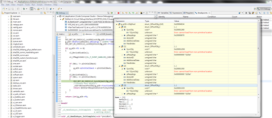

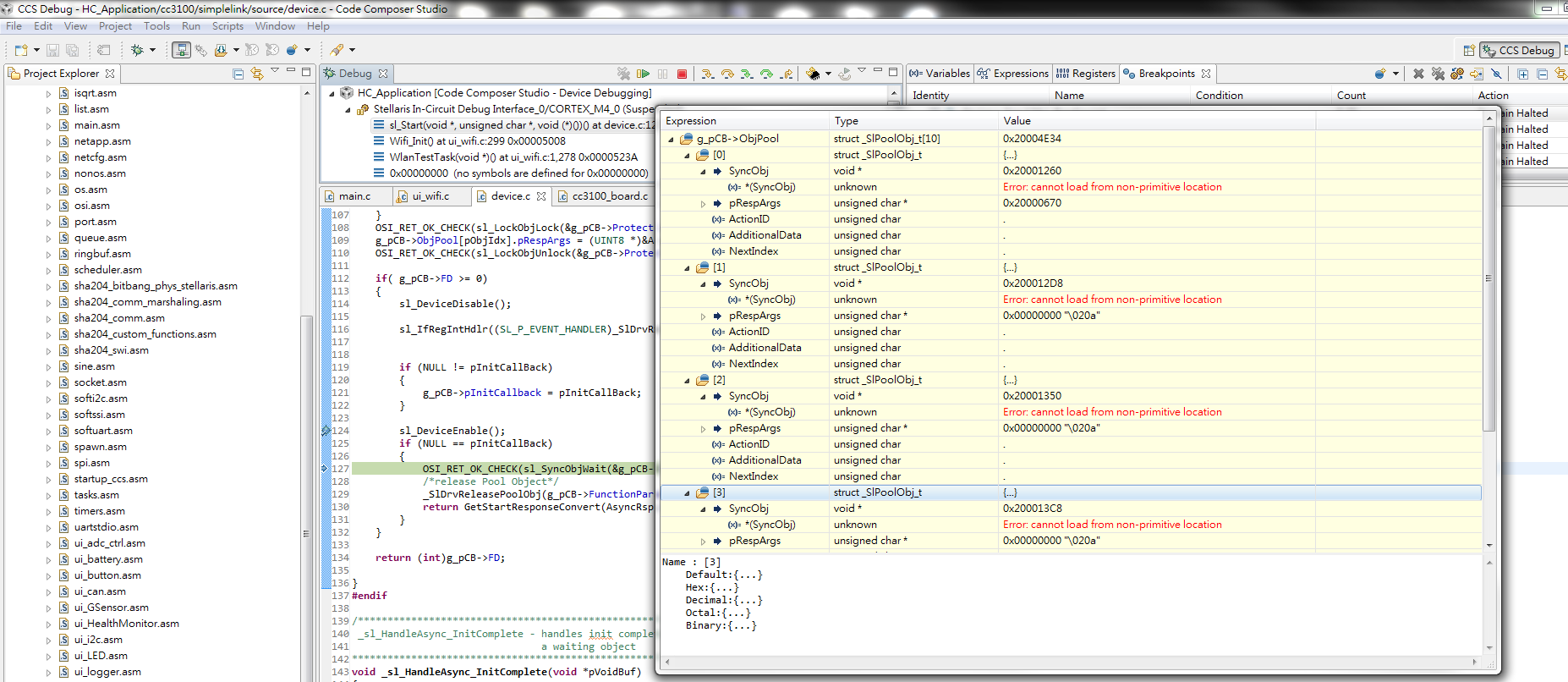

    My platform is TM4C123G EVM + cc3100 BP2.0, SDK0.5.
    This platform can work on non-os environment, so SPI/IRQ should be connected properly.
    I use the same SPI and simplelink source on OS environment.
    I check one different in the init process between non-os and os.
    In os part, it seems that there is something wrong in the sync obj list, I attach the screenshot of CCS.
    Do you know what is the cause of this?
    thanks
    Gavin
