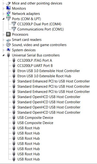

I'm trying to set up my CC3200 board according to the instructions here:
http://www.ti.com/lit/ug/swru376a/swru376a.pdf
When I try to debug in CCS, I get the following error output:
Cortex_M4_0: GEL Output:
Memory Map Initialization Complete
Cortex_M4_0: Error connecting to the target
In the guide in step 2.3 Install USB Driver, I noticed the following:
When I updated the driver for the first of the two listed
"USB <-> JTAG/SWD" devices, they both disappeared and were
replaced with two devices
"CC3200LP JTAG Port A" and "CC3200LP UART Port B"
For step 7
Repeat the same steps for the instance of “USB Serial Port” that should have appeared as shown in
device manager
-> No USB Serial Port appeared, and it looks like the device does not have a serial port
assigned at all.
