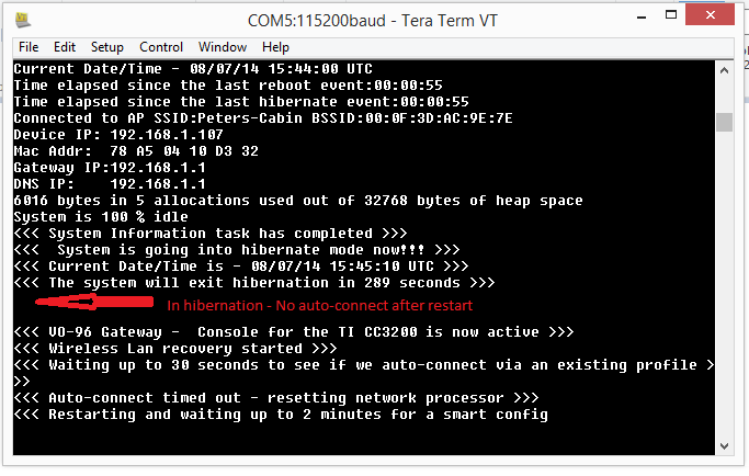

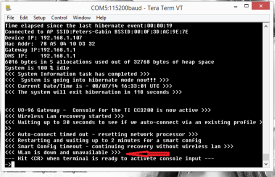

My CC3200 Launchpad fals to auto-connect back to the wlan after it comes out of hibernation.  The connection policy was set to Auto + SmartConfig.  If I manually reset the device while waiting for the auto-connect it will work perfectly.
I terminate the wlan connection and stop the NWP device with a 5 second (5000 ms) delay prior to starting hibernation.
I can successfully config it with my iPhone during this 2 minute wait period.

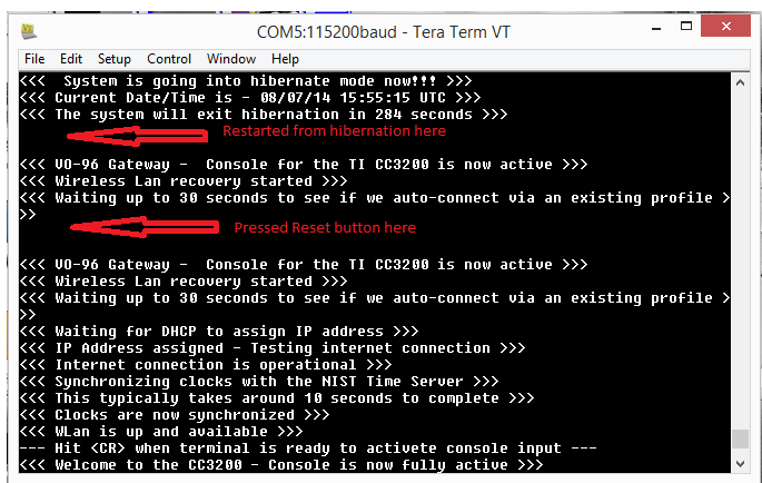

Here is a snap of pressing reset.  Obviously the profile and connection policy is still set OK.  There is something in the NWP that is treating a hibernation restart differently to a normal restart
This seems to make the hibernation feature pretty useless unless the customer is always handy with his smart phone app whenever hibernation occurs :-)

  • Jiendra
    Well step 2b is the problem:
    The IP acquire event never arrives after hibernate.  If I power cycle or press the reset button it works flawlessly
    Everything else listed I do.  It all basically copied from  your wlan_station demo code.
    I've tried:
    1. On  hibernation restart I've tried reenabling/reestablishing Connection Policy and DHCP, doing a SOCReset and delaying 30 seconds before doing sl_start, all to no avail.
    Peter
  • Issue is solved
    The code I have in the WLAB_Start function is:
    	VOGW_Console_Log ("<<< Wireless Lan recovery started >>>");
    	status = sl_Start(0,0, 0);				// start the WLan
    	sysStatus |= VOGW_WLAN_STARTED;
    	if (status != ROLE_STA) {
    and over in the WLAN_Event handler:
    oid SimpleLinkWlanEventHandler(SlWlanEvent_t *wlanEvent) {
    	int		i;
    	char	msg[50];
    	if (!(sysStatus & VOGW_WLAN_STARTED))
    		return;
        switch(wlanEvent->Event) {
            case SL_WLAN_CONNECT_EVENT:
            	sysStatus |= VOGW_WLAN_CONNECTED;
    The Fix is:
    WLAN_STARTED flag is to ensure that spurious WLAN events are discarded unless the WLAN is started.  Howerver on a hibernation restart, the WLAN connected event is received before the WLAN_STARTED flag is set.  Setting the flag immediately before, rather than immediately after issuing the sl_start solved the problem
