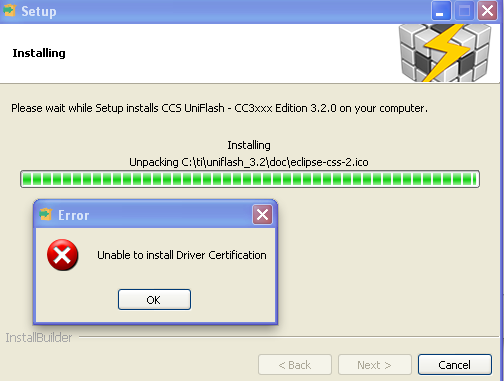

I'm trying to install uniflash simplelink 3.2.00065 on my Windows XP SP2 instance (yes, old, but never fails) and get the error "Unable to install Driver Certification" and then it quits when you OK the box. How to proceed?

This is a known issue and should be fixed in next releases.
Please take a look at the following E2E link: http://e2e.ti.com/support/wireless_connectivity/f/968/p/358690/1269223.aspx#1269223.
Basically, when I checked it a while ago (hard to find XP these days :)), you need to click OK, abort the installation but without unistalling Uniflash. This should work as installation is finished in this stage. Please check it.

I am closing the thread, if issue still exist please open a new thread and add a link to this one for reference.

the program seems to run after following your instructions. I haven't tried actually flashing anything to see if there's some kind of damage to the program... just got the dev kit today.
