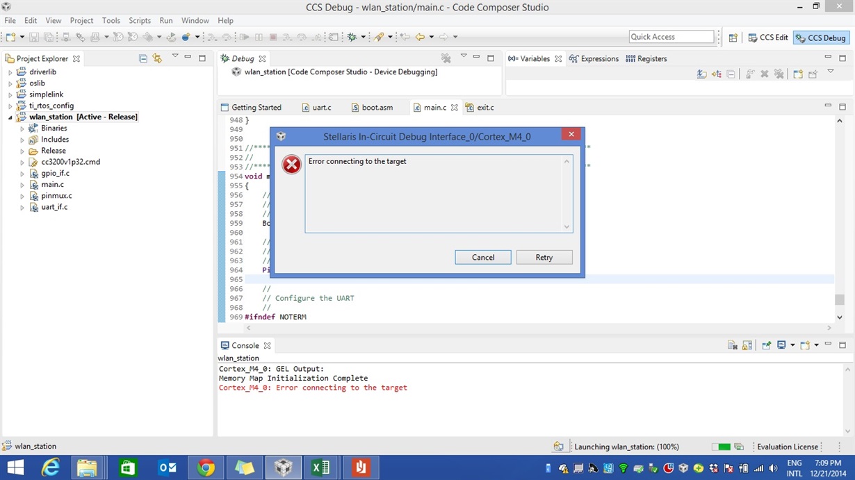

TMS,TCK, TDI, TDO, Vcc & Gnd connections are made from CC3200 launchpad to external(CC3200) board but unable to program the board and getting the below error.
Please let us know how to debug the hardware as the schematics of the external board is a copy of CC3200 launchpad cant able to guess the issue.

  • Can you also connect the RESET output from the Launchpad (pin P2.5) to the target board.
    Also confirm that the target board has the SOP values held at 000.
  • Can you confirm if the CC3200 has booted up correctly. Please check for the following
    1. Voltage on VDD_ANA (pin 48) . It should be 1.8V
    2. Voltage on VDD_DIG (pin 9) . It should be 1.2V.
    If you cannot see these, then the hardware has an issue.
    If this is OK, then check if the 40MHz clock is oscillating..

    We measured the voltage i.e. @ VDD_ANA : 1.02V and VDD_DIG: 1.44V, If this is the case what could be the hardware issue as schematics and the component values we used are as per ref schematics, so can you please help us in debugging hardware??
    The SOP settings are 000, also we tried settings for 2-wire programming(100) but status remained same.
    Interesting thing is When we power up the board 2 LED's glow up that are connected to GPIO_10 & GPIO_11.so what it indicates??

  • From looking at your voltages it looks like the hardware is not booting up correctly. Can you connect an oscilloscope at the VDD_ANA pin and send us the snapshot after toggling nRESET from low to high. Also the VDD_DIG should be at 1.1 to 1.2V. Are you sure you are looking at the correct pin?
    Also send us a picture of your setup showing the power supply connections.
  • The wire lengths doesn’t look too long. All wires needs to be same length, including Vcc and GND.

    I am getting the voltages as given in check list, but I am getting "error connecting to Target" while programming so can you please guide me with next steps to debug??
  • If the voltages look fine, then the suspect is the state of the SOP[2:0] pins. it should be 000.
    If that is also fine, then check for TDO/TDI swap.
    Is programming the s-flash over the UART using uni-flash tool working fine? This would imply no major issues.
