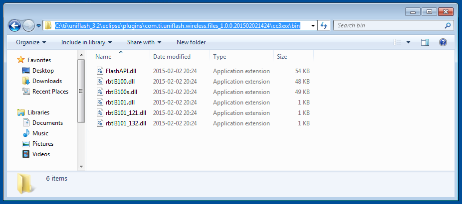

I have the exact same problem as Dan OShea.
I've tried on several new windows (XP, 7, 2008 server) installations and I get the exact same problem.
And I have the same DLL files as Dan listed.
Any Idea what's wrong or missing?
    The only way I am able to reproduce this problem on my machine is if FlashAPI.dll is actually missing from the folder in your screenshot, so it must be having problems with finding it for some reason.
    The error message is supposed to print out the exact path of the DLL it is trying to load, but there seems to be a bug with that. So I'm including an updated version of a file that will allow us to capture additional debugging information. Can you download the attached FlashCC3xIntegration.dll file and replace the one in \eclipse\plugins\com.ti.uniflash.common.libs_1.0.0.201502021424\libs\ and try your test case again (back up the original file to be safe)?

    C:\ti\uniflash_3.2> dir C:\ti\uniflash_3.2\eclipse\plugins\com.ti.uniflash.wireless.files_1.0.0.201502021424\\cc3xxx\bin\FlashAPI.dll
     Volume in drive C has no label.
     Volume Serial Number is 160F-EE89
     Directory of C:\ti\uniflash_3.2\eclipse\plugins\com.ti.uniflash.wireless.files_1.0.0.201502021424\cc3xxx\bin
    2015-02-02  20:24            54 784 FlashAPI.dll
                   1 File(s)         54 784 bytes
                   0 Dir(s)  590 874 619 904 bytes free
    C:\ti\uniflash_3.2>

  • All,
    I think I found a potential fix for this.
    Can you try downloading the attached FlashAPI.dll and replace the one in \eclipse\plugins\com.ti.uniflash.wireless.files_1.0.0.201502021424\cc3xxx\bin\?
    https://e2e.ti.com/cfs-file/__key/communityserver-discussions-components-files/968/2475.FlashAPI.dll
    The problem seems to be that the library was compiled with a different version of the C++ library, and therefore there are some dependency problems if a particular c++ redistributable is missing from the system. The updated library is meant to hopefully fix this problem.
    Please let me know if this update fixes the problem for you.
    Ricky

    6278.FlashAPI.txt
    Ricky
