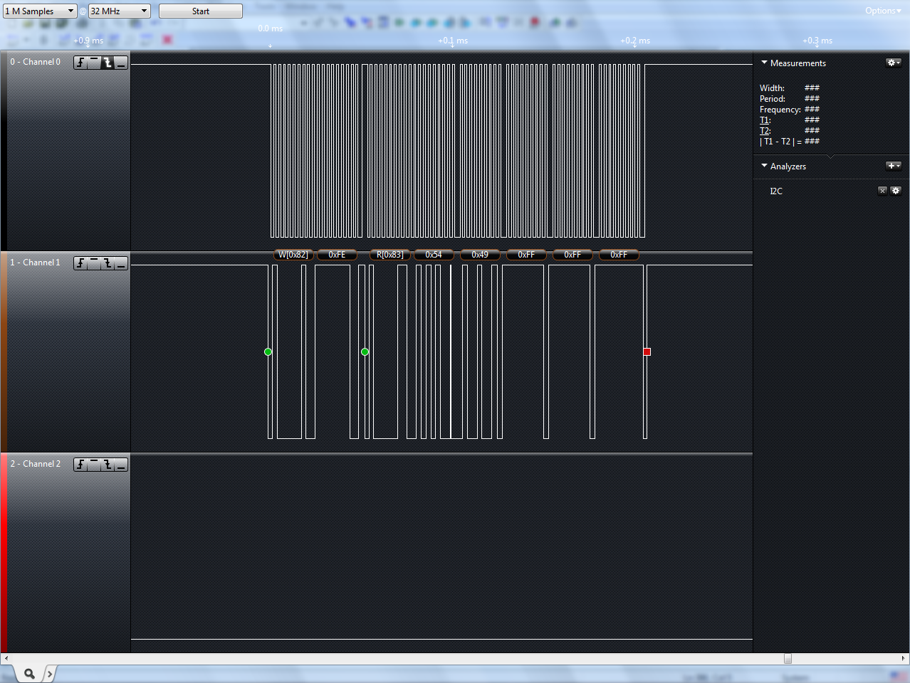

I am trying to write a driver for the CC3200's I2C library in master mode. I want to use interrupts - no polling. However, my code does not work when only a single byte is written to the slave - the message is sent on the bus, but the I2C_MASTER_INT_TX_FIFO_EMPTY interrupt fires constantly. If I try to write multiple bytes of data, then the I2C_MASTER_INT_TX_FIFO_REQ interrupt fires once per byte, which is what I want (although other interrupts fire too). I must figure this out so I can do Write-Then-Read operations.
Below is an excerpt from my driver, containing the initialization and read functions, as well as interrupt service routine and applicable global variables. Anyone see something I'm doing wrong?
