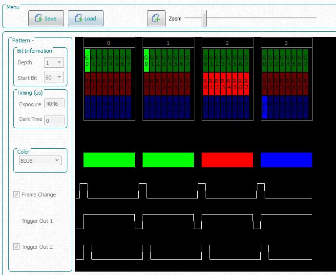

    2) Additionally, if I stream 24-bit frames and select all 24 bits for a pattern are all bit planes shown in order (G0-G7-R0-R7-B0-B7) or randomly...?
    You can select the bit frames to display in exactly the way you want them to display. For example, I took a screenshot of my GUI setting up a pattern where I display G0, G0 again, all 8 bits of R, and B0. You can set it the way you want. You may be remembering two things. The first is that Video Mode (not Video Pattern Mode) has spatial and temporal dithering algorithms because it is meant for display applications. I would not recommend Video Mode for your application. The second part worth noting is if you use our 8-bit pattern sequence, it was optimized for speed and because of that, the bits are not shown in 0-7 order, but they are all exposed for the proper amount of time within the pattern. This is true for any mode.
