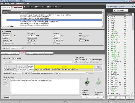

Does the SmartRF Studio 7 application allow the CC1200 eval to be configured for FCC 15.247 wideband modulation?  Is there a document that describes the values to use for the CC1200?
  • Hi Mike,
    Yes, you can start with the typical settings shown on the top panel of SmarfRF Studio then you check box against 802.15.4G on the botton panel.
    For example: Symbol Rate: 500ksps, 4-GFSK, max throughput, ETSI Standard (868MHz)
    Please see the following image.

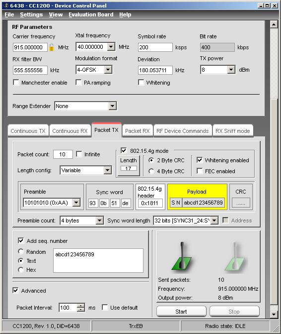

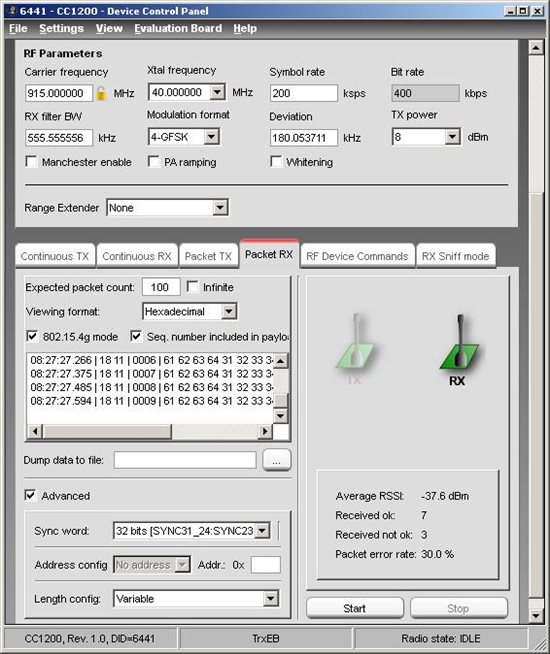

  • Thank you for the tips / ppt link.  I think I have my two devices set up correctly, but I am getting high packet error rates.  Do you see anything in the screen shots below that would cause the high packet error rate?

  • Using your suggested starting point, and ending with the same values as shown in the previous captures, resulted in similar results, 20-30% PER.  Setting the register values you suggested on both the Tx and Rx devices resulted in much worse results, 70-80% PER.
    Also, I can't seem to save a Cfg and then open it again later, I get no received messages.  If I start from scratch, and set up each parameter again, it seems to work fine.
  • I used values similar to those, but for 915MHz.  I can send/receive packets, but I have a 30% PER.  I noticed the Advanced Parameter Panel has an Enable Coding Gain checkbox that is recommended for "FCC digital modulation", but if I check that box all my sends fail.

  • First of all, you can start with Standard settings as shown below.
    Symbol Rate:50KBPS, 2-GFSK, IEEE802.15.4G compliant, dual sync word, ARIB Std (868MHz)
    Double click on the above standard setting in the SmartRF Studio and then change the frequecy to the desired (915MHz).
    If it works then try the other settings
    You may save your Register Configuration by using File - Save as - in SmartRF Studio and post the config file in XML.

  • Tested 200 kbps with processing gain (4 chips per bit, 50kbps throughput) on the bench using SmartRF Studio + TrxEB + CC1200EM.
    "Packet TX" xml file attached. Use the same for RX - simply change tab to "Packet RX"
