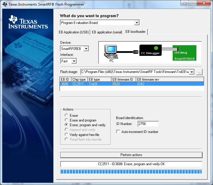

  • Hi Juri,
    Just for the information: It is possible to change the Device Id if you have two TrxEB boards. By connecting the two boards in a special way and programming the bootloader with the SmartRF Flash Programmer this is possible.
    One TrxEB board should act as the programmer in the same way as the CC Debugger. The following connections should be made:
        Programmer        Target
        P7.4 (GPIO2)       P200.3
        P7.8(GPIO0)        P200.4
        P7.10(RST)          P200.9
        P7.20(GND)         P7.20
    Since the P200 header is position under the LCD display there is also an alternativ on the back side of the TrxEB board. There the debug interface of the USB MCU is available as three pads. In that case it looks like this:
        Programmer        Target
        P7.4 (GPIO2)       DC
        P7.8(GPIO0)        DD
        P7.10(RST)          Reset
    Below is a screenshot from the SmartRF Flash Programmer:
    Select the bootloader image and specify the new Board identification. In the example above it is "2756".
    The bootloader image can be found together with the installation of the SmartRF Flash Programmer. Typically this would be: C:\Program Files (x86)\Texas Instruments\SmartRF Tools\Firmware\TrxEB
    The bootloader image is called usb_bootloader_trxeb_combo.hex.
