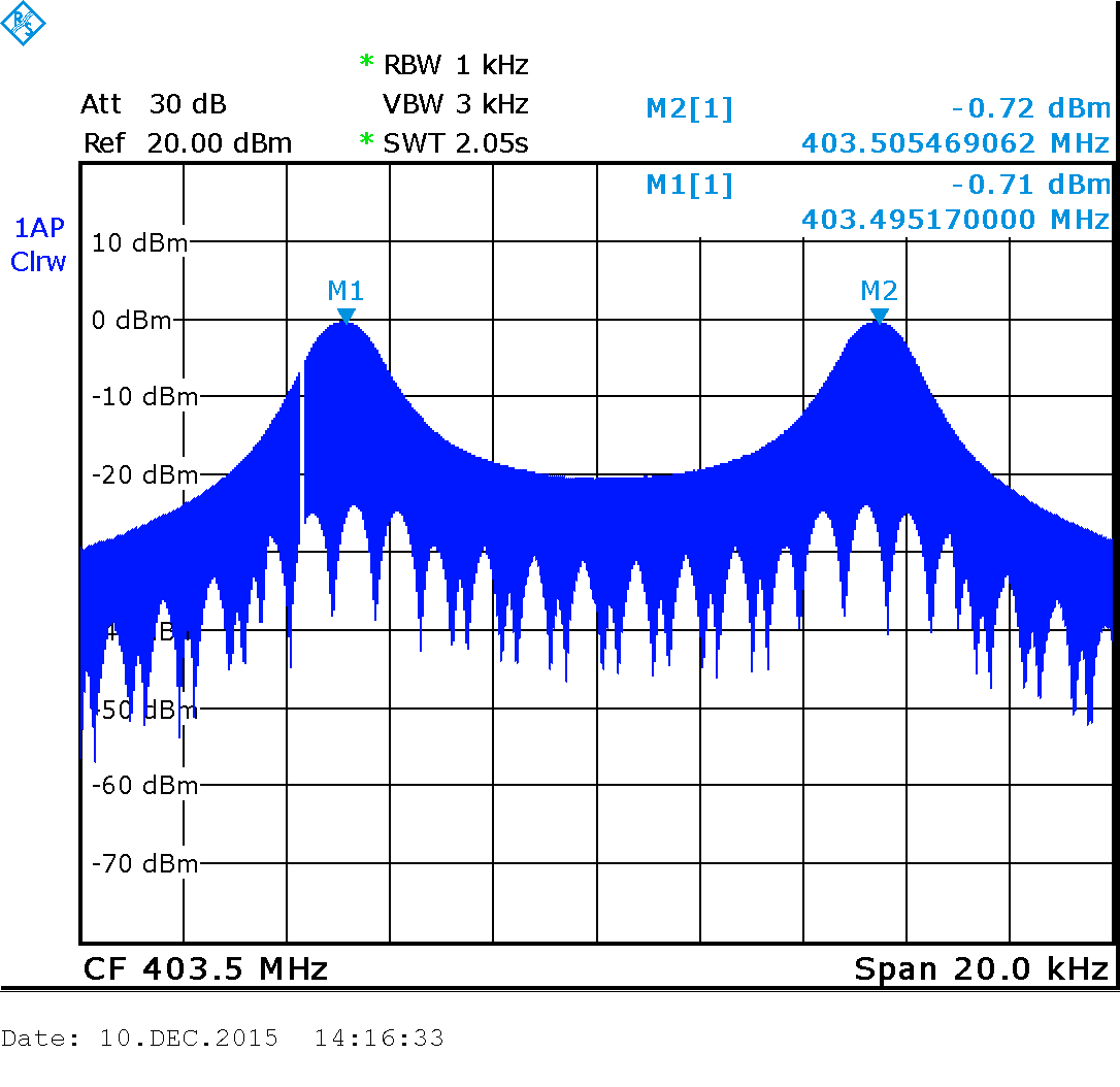

 I have established RF link between CC1101 evaluation module <--> CC debugger <--> SmartRF Studio (PC) as transmitter node and CC1101 evaluation modue <--> CC1101DK433 Development kit <--> SmartRF Studio (PC)  at the receiver node. I am able to transmit and receive packets and able to confirm the same using SmartRF studio.
   Now, I want to use MSP430F5529 launchpad<--> CC1101 Evaluation module at the TX side with the same receiver setup at the RX side. I have successfully interfaced the microcontroller with the RF module via SPI channel and I'm able to read/write registers. Also I can strobe STX and can see the peaks in the spectrum for BFSK scheme using spectrum analyzer. But I'm unable to receive the data at the RX mode. I have used the same RF settings that has been generated by the SmartRF studio while using CC debugger at the TX side. I have attached the block diagram of the scenario for reference. It would be of great help if someone can help me in providing suggestions with this regard.
  • - Could you post the spectrum you see and state which datarate and deviation you are using? Use lowest possible RBW to clearly show the modulation.
    - Try to set up the receiver with 0xAA as sync word and turn on carrier sense if required. Use fix length packet and "RF device commands" in SmartRF Studio to see what you are actually sending. Test this with the working transmitter first.
    - If you have trouble with the TX FIFO you could be sending just a preamble, if this is the case you will see it on the spectrum (compare with the working transmitter)
    - See www.ti.com/.../swra109c.pdf and processors.wiki.ti.com/.../Perf_value_line_easylink on how to send a packet using the FIFO.
  • Thanks for the reply!
    Please find the image of the spectrum below. The RF specs are:
    Carrier Frequency: 403.5 MHz
    Deviation: 10 kHz
    TX power: 0 dBm
    data rate: 1kBaud
    Please find the code below:

  • I briefly looked at your MDMCFG settings and they give the following
    Data rate: 1.2 kbps
    Deviation: +/-5.16 kHz
    RX filter BW: 650 kHz
    Why are you using such a large RX filter BW? Do you have a large crystal tolerance in your system?
    Your IF frequency (FSCTRL1 register) is approx 150 kHz and this is too low for RX BW of 650 kHz.
    I assume you have used 1.2 kBaud "typical settings" as a starting point to generate the settings. If you change the system parameters (e.g RX filter BW, deviation, data rate, modulation, ....) manually under "RF parameters" some registers (e.g FREND1, AGCCTRL, FSCTRL1....) will not change. Only those registers that are calculated based on your manual entry (e.g MDMCFG when changing data rate and RX filter BW) will change. FREND1, AGCCTRL, FSCTRL1 and a few other registers settings are not calculated by SmartRF Studio, but they still need to be set according to the RX BW used.
    What you need to do is to select the "typical setting", which has the same or greater RX filter BW than you are going to use as the FREND1, AGCCTRL, FSCTRL1, FIFOTHR, TEST2, and TEST1 settings to use depend on the RX BW. As an example, assuming the desired RX BW is 650 kHz you should start with the the 500 kbps preferred setting (812 kHz RX BW) and change the data rate, deviation, RX BW, and modulation format manually you get the right settings.

  • TER,
    I checked it in SmartRF Studio using CC debugger but not with the MSP430 microcontroller setup
    How can the spectrum be different for preamble transmission and packet transmission? Both will show two peaks corresponding to f1 and f2 for BFSK. Do you mean that preamble transmission will show continuous peaks without any fluctuation and packets will have a fluctuation since its not a continuous transmission?
