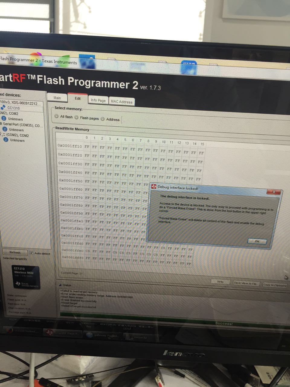

Hi Experts,

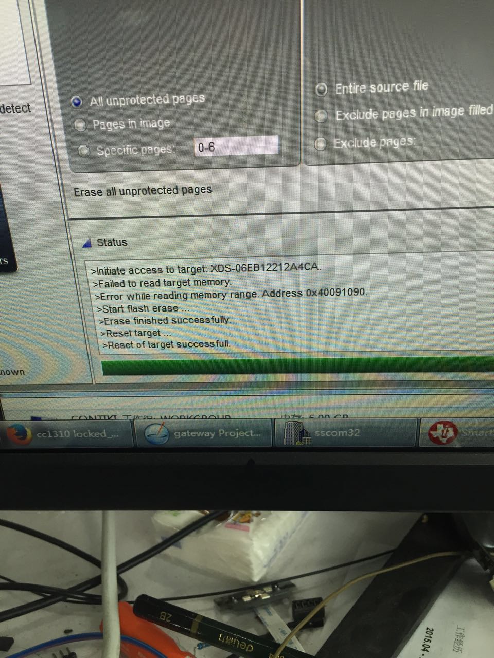

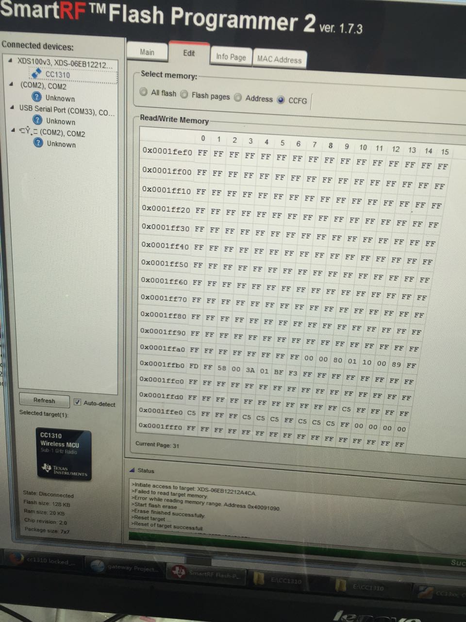

My customer wants to disable the JTAG for their end products. During their testing, customer accidently revise the CCFG file, as below picture 1 show. The last three line C5 was modified to 00; Then, customer find it's unable to access the chip (The Flash Programmer could still identify it's CC1310, but unable to flash). The Forced Mass Erase can't be finished successfully. As below picture 2 and 3 show. This is somehow similar to the thread :
Could you help advise how to handle the issue? Thanks.
