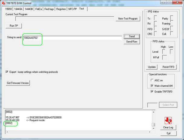

    Here is how the code was tested:
    Using a TRF7970AEVM and this GUI in test mode (use “Send” button):
    The string that was sent to the RF430FRL152H:
    1802AA0702
    18 – raw string command (TRF specific) (omit this byte if sending using a NFC handset or another reader)
    02 – ISO/IEC 15693 high data rate flags, handled by RF stack
    AA – custom command ID (can be between A0 to Dx), handled by RF stack
    07 – TI manufacturer ID, handled by RF stack
    02 – this is the payload byte, it is echoed, payload can be up to 26 bytes including this one, this byte is what the RF430 firmware receives
    Result:
    [0002]
    00 – no error
    02 – echoed from received byte
    Return payload can be up to 30 bytes plus 2 bytes for CRC total of 32 bytes.
     If anything other than one byte is sent the result will only be 0x01.
