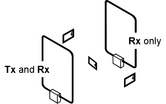

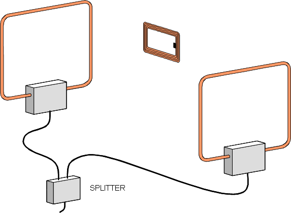

    Further, in this application, since the badges are small relative to the coils needed to reach out this far - (this is the Vicinity part of the technology) - in many cases, you will see that gate antennas (or pairs) are arranged such that there is enough density in the area where the tag will pass and oriented and phased correctly so as to induce the maximum amount of current from one side to the other, while still accommodating possible variations in orientation of the transponder itself as it passes through the field.
    the images below illustrate simply two of the popular arrangements, with transponder orientation considerations.
    in phase - this is used when tag orientation is known and controlled

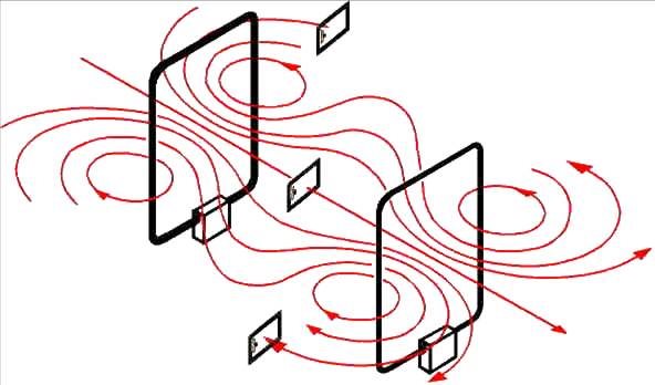

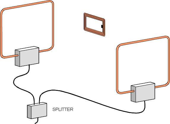

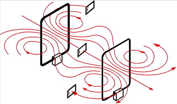

    out of phase (here using a splitter, also possible using complementary or multiplexed antennas, as well as adding delay(s) with coax cables)
    these are the tag orientations generally seen in the access control gate application.
