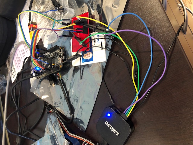

I'm trying to run the demo from app note SLOA210 (Rev B).  The precise hardware listed in the app note does not appear to be available any more.  I couldn't even find a schematic for the RF cape!  So that leaves me guessing at the proper connections between these boards.  I'm using DLP-7970ABP Rev 4.3 hardware.  Here's my current hookup:
Function AM335x Pin BBB location DLP location
SS enable gpio1_5 (V8) P8, pin 22 not currently used
EN gpio2_3 (T7) P8, pin 8 Pin 10
EN2 gpio2_4 (U6) P8, pin 10 not currently used
IRQ gpio0_31 (U17) P9, pin 13 Pin 18
sclk spi1_sclk (A13) P9, pin 31 Pin 7
miso spi1_d0 (B13) P9, pin 29 Pin 14
mosi spi1_d1 (D12) P9, pin 30 Pin 15
CS spi1_cs0 (C12) P9, pin 28 Pin 9
GND P9, pin 46 Pin 20
3.3V P9, pin 4 Pin 1

So at this point I’ve made one attempt at reading the card.  Nothing came out.  My RFID card was laying on the DLP board the whole time.  If I try to initiate another read, here’s what I see:
root@am335x-evm:~# test/test-adapter poll nfc0 on Initiator
org.neard.Error.Failed: Device or resource busy
I need to reboot the entire board in order to attempt it again.
There’s a jumper on the board to select IRQ as being “1” or “2”.  It was populated on “2” initially so now I’ve tried “1”.  No change in behavior.
I suspect this isn't working because I don't have things wired up correctly.  Any inputs would be appreciated.

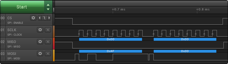

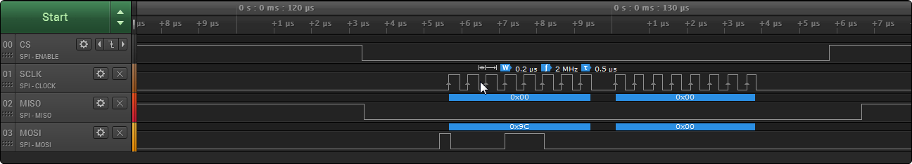

  • I've hooked up a logic analyzer to better understand what's happening.  Initially I put it into oscilloscope mode.  I could see the voltage levels were the expected 3.3V levels.  However, the signals themselves looked horrible so I slowed the interface way down to 100 kHz so that things look nice and clean.
    Then I switched to the logic analyzer mode and switched on the SPI analyzer.  In all the transfers that have occurred the MISO bit has been zero the entire time.  So it seems to me that something major is wrong with the TRF device, e.g. like it is still in reset or something.
    Here's an arbitrary screenshot just to give you an idea:
  • Hello Brad,
    Is Data CLK is at 100kHz? You can't do that, minimum specification is 2 MHz for Data CLK. Saleaer should have no issue sampling a 2 MHz SPI clock. I can review full logic files if needed, Saleae is my go-to for debug.
  • Also should comment Saleae o-scope isn't good for digital signals to check for clean signals, you need to use a bench o-scope for that. Saleae o-scope is better for sub MHz signals.
  • Ok, I switched back to 2 MHz:
    I still see the same issue -- the TRF only responds with zeros...  Suggestions?

  • Ok, I just tried it. I confirmed in the oscilloscope mode that the voltages were still 3.3V. It behaves the same. I still only get zeros on the MISO.
  • Can you save & attach (or email) a .logicdata file so I can review it? I might be able to identify something quickly that way. Should have all 4 SPI lines, IRQ, and since it is in question as well, EN to be safe too.
  • Thanks, Ralph.  Here it is (captured in Logic 1.2.18):
    20 MHz, 300 M Samples.zip
    I'm assuming it keeps all the labels, etc. for the various channels.  Just in case though, here's how it is setup:
    • 0 = CS
    • 1 = SCLK
    • 2 = MISO
    • 3 = MOSI
    • 4 = IRQ
    • 5 = EN
    Looks like EN transitions 0->1 before any SPI activity ever begins, and it stays there.  I don't see any activity on IRQ, but then again I don't find that all that surprising given that we can't seem to read any data from the device!

    Looking at the timings on the logic analyzer, I'd agree with you that it looks like the the AM335x SPI is using Mode 1 (which makes sense given your comment about hard-coding it).
  • I was looking at the initialization sequence and comparing with the TRF7970A data manual (Section 6.11 TRF7970A Initialization).  My observations are:
    1. Steps 1 and 2 are completed.  I see on the MOSI data of 0x83 and 0x80 being transmitted.
    2. It looks like Steps 3 is missed.  I don't see the 1ms delay.    After the 0x80 is sent there is only a 15us delay before the next transfer begins (0x0B, 0x01), which looks to correspond with Step 6.
    3. Step 4 seems to also be missing (reset FIFO).
    4. I see the SYS_CLK register being written, though it is a big further into the log (i.e. it is byte #7 to be transmitted on MOSI).  The subsequent byte (the data) is ZERO.  Is that expected?  Looking at the register, it looks like that disables the OSC.
    This section is new (is there some way to be notified when there is a document update??).  However, I worked very closely with Josh Wyatt (614) and  at the time to get the init sequence correct and it has been working reliably ever since (until now, possibly).  If I recall correctly, it does what other TI products at the time did and I'm hesitant to change anything in this area without clear evidence that it matters and that it is correct by someone at TI that "knows".
    Is there a new revision of this part?  If so, them maybe the init sequence is different for the new one.
    Re: SYS_CLK reg - writing zero should okay as we don't use the SYS_CLK output (as far as I can tell from the schematic).

    I would simplify this down a whole lot more. Let's make sure you can read back a register correctly. 0x0F is a good one because when the chip runs, then the oscillator on bit will be 1. So you will always get a non 0x00 reply from that register.
    That the response there was 0x00 is my point of concern.
    The oscillator is part of the BoosterPack by the way.
    If you can get your hands on an MSP430 LaunchPad like one of the two I mentioned, that'd be a very quick way to make sure your BoosterPack hardware wise is fine. If you have a dead BP then it would make sense why none of this is working...
    Mark RE the startup sequence, your setup is fine. Our Datasheet has a stricter version but that is just because most customers don't use our software and so we have the most reliable way that works for other MCUs as well on there. There isn't a new chip version, but the DS got updated a lot to clarify properly written or ignored points including start-up sequence.
    There isn't a lot of rocket science to this though, if the SPI connections are fine, the right SPI mode is used (I checked the polarity and phase on the LSA capture that was one of my main goals with getting it), and EN is handled right (which it is), then I am suspicious of the BoosterPack as a whole given how old it is. Who knows what it's been through.
