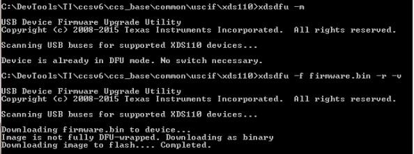

We have a customer that has put the XDS110 tool chain directly onto their board for ease of debug.
When USB is connected, the TIVA processor appears to enumerate properly as a "Stellaris Device Firmware Upgrade":
Following the firmware update instructions, we see that the download of the flash image appears to complete successfully:
We then expect that the device will re-enumerate as the debugger, which is what happens with a launch-pad.
However, we see that Windows 10 re-enumerates, but it just comes up again as the Stellaris Device again.
Clearly we seem to have a good USB connection; do you have any idea what is happening that it seems to revert back to the Stellaris...Upgrade?
