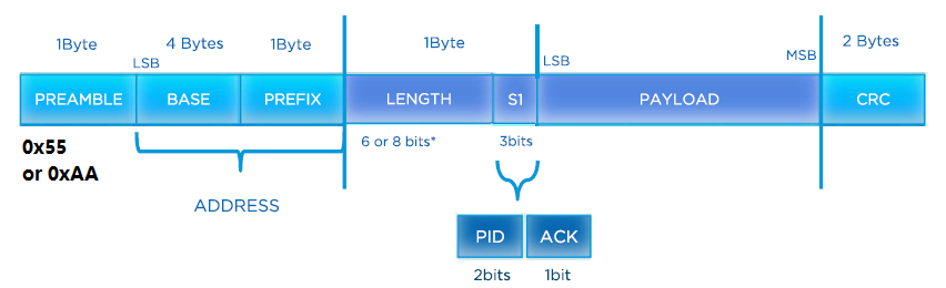

Can we set up CC2640 on below configuration?
Datarate: 1Mbps,
Payload_length: 64,
TX channel = 2452MHz;
RX channel = 2428MHz;
Packet format as below
