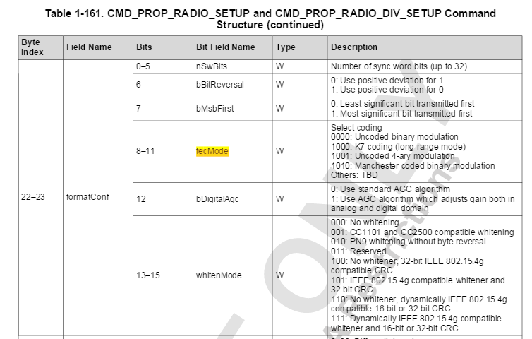

I'm wondering how to enable 4-GFSK mode using the CC1310 and SmartRF06 EB. According to the documentation 4-GFSK is supported but in the manual I can only find “GFSK” which in tests appeared to
be 2-GFSK mode ( CMD_PROP_RADIO_SETUP: modulation – modType=1 ).
Can anybody help me with the settings for 4-GFSK?
Best regards!
  • We have not characterized 4-GFSK yet, only verified functionality.
    Setting fecMode = 9 enables 4-GFSK
    For the time being we can only offer limited support on 4-GFSK
  • Thanks for your reply! It's working with two CC1310.
    I still have a problem, since I currently need to work with a CC1120(TX) and CC1310 (RX) together. On 2-GFSK I can received the packages correctly. Using 4-GFSK (with the other settings unchanged in SmartRF Studio) however I receive seemingly random bytes. So it appears to be related to something that is affected by this change from 2 to 4 GFSK (using SmartRF Studio, not sure what might be changed automatically). Do you have any suggestion which register/setting might be responsible? Or something that might be worth looking at?
