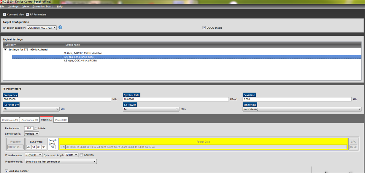

I would like to test DSSS mode in CC1310 DK.
As there is no documentation about it (beside errate which tells 'not supported yet') I asked some days ago in this forum how to test.
I understood I can activate it with SRF by choosing Long Range Mode, see picture.
But this seems to be nothing else than a normal 2FSK with 39kHz ChBW.
Pls. advice

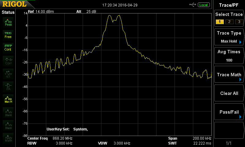

  • This should be correct, how did you expect the spectrum to look like?
  • This spectrum is not what DSSS should look like: it's normally a flat spectrum utilization over the wole occupied bandwidth.
    The spectrum above is typcial 2FSK.
    Furthermore sensivity represents ~-113dBm, not -122dBm as expected for DSSS.
  • DSSS does not automatically mean a flat spectrum. In this case every bit is spread by a know bit pattern causing a broader spectrum but not a flat spectrum.
    Not sure where you have the -113 from? According to the datasheet 625 bps gives -124 dBm sensitivity.

    So I tried what fecMode is configured in SmartRF Studio:
    • normal mode (50 kbps, 2-GFSK, 25 kHz dev.) --> fecMode = 0x0
    • long-range mode (625 bps) --> fecMode = 0x8
    But I have no idea of what happens with the signal when enabling long-range mode. Is there any further information about long-range mode?
  • All,
    The LRM scheme in the CC1310 comprises of a convolutional encoder of rate ½ is followed by a direct sequence spreader (DSSS) with variable spreading length. The output of that module is finally fed to the 2-(G)FSK modulator. The modulation kernel (symbol rate, frequency deviation) can be user defined.
    So your measurements are correct, you should expect a normal FSK looking spectrum.
    /TA

    Could you confirm exactly which radio settings in SmartRF Studio control the DSSS module?  e.g., if I wanted to use DSSS but with a higher data rate than the stock 625bps LRM, would it be sufficient to change only the symbolRate setting (e.g. to 40kbaud for 2.5kbps) and leave all the other LRM settings the same?
    Thank you.
  • If you want to double the datarate it is sufficient to double the symbol rate and the deviation. If you need even higher datarate you would also need to adjust the Rx Bw.
  • Got it, that makes sense. And regarding the radio command settings, which commands control the DSSS functionality? I see in SmartRF studio fecMode is 0x08 for LRM vs 0x00 for 50kbps 2-GFSK, are there any other parameters to be aware of?
  • There are couple of extra overrides specific to LRM mode to choose the DSSS mode and MCE_RFE override. This setting can be copied from smartRF studio export as well .
