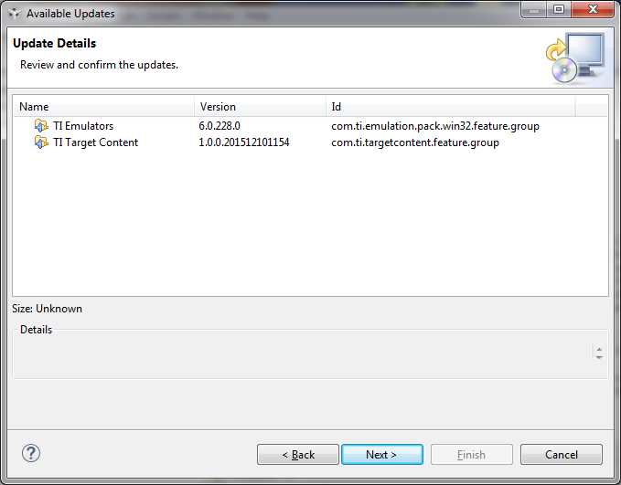

I just received my new LAUNCHXL-CC1310 LaunchPads :-) and I called the CCS Help / Check for updates, I'm having this error message:
Cannot complete the install because one or more required items could not be found.
  Software being installed: CC13xx/CC26xx Device Support 1.16.2.00 (com.ti.ccstudio.cc26xx.devicesupport.win32.feature.group 1.16.2.00)
  Missing requirement: CC13xx/CC26xx Device Support 1.16.2.00 (com.ti.ccstudio.cc26xx.devicesupport.win32.feature.group 1.16.2.00) requires 'com.ti.emulation.pack.win32.feature.group 6.0.83.0' but it could not be found
If I check whats installed I have:
CC26xx Device Support    1.15.1.01    com.ti.ccstudio.cc26xx.devicesupport.win32.feature.group    Texas Instruments
TI Emulators    6.0.14.5    com.ti.emulation.pack.win32.feature.group    Texas Instruments
My current Code Composer Studio Version: 6.1.2.00015
So I guess I need the CC13xx/CC26xx Device Support new version. Apparently CCS is not finding com.ti.emulation.pack.win32.feature.group update to 6.0.83.0 so where can I find it?

  • My current Code Composer Studio Version: 6.1.2.00015
  • I have another version of CCS installed on my portable PC so I tried to update it and it worked, it found the latest emulator version:
    After this update I installed TI-RTOS for CC1310 and imported a sample project, on first connect it asked to update the debug probe:
    After the debug probe firmware update it worked!
    So I went back to my desk PC, downloaded the ccs_setup_win32.exe from TI site again and reinstalled CCS. After the reinstall, the update was working, so I made an update and all works fine now.
    So, the solution to this problem is to make a complete reinstall of CCS.
