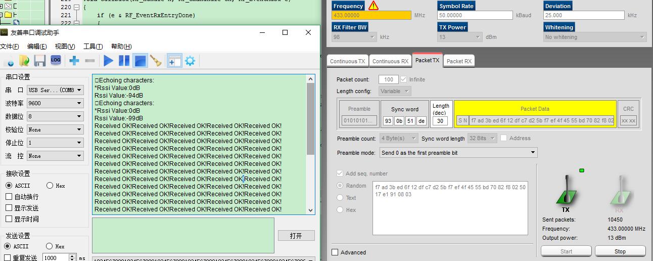

            rssi = RF_getRssi(rfHandle);
            sprintf(string1,"Rssi Value:%ddB\r\n", rssi);
            UART_write(uart, string1, strlen(string1));
    When packet received correctly(packetreceived is set in RX Callback), print "Received OK" and the current RSSI Value, but the result is below:
    Received OK!
    Rssi Value:-99dB
    Received OK!
    Rssi Value:-101dB
    Received OK!
    Rssi Value:-104dB
    Received OK!
    Rssi Value:-94dB
    Received OK!
    Rssi Value:-95dB
    Received OK!
    Rssi Value:-101dB
    Received OK!
    Rssi Value:-100dB
    Received OK!
    Rssi Value:-100dB
    Received OK!
    It's very strange that the RSSI Value is very low, and if I modified my code if(packetReceived) to if(1), then correct RSSI value can be printed occasionally,like this:
    Rssi Value:-99dB
    Received OK!
    Rssi Value:-101dB
    Received OK!
    Rssi Value:-104dB
    Received OK!
    Rssi Value:-14dB
    Received OK!
    Rssi Value:-95dB
    Received OK!
    Rssi Value:-101dB
    Received OK!
    Rssi Value:-100dB
  • Why is this strange? As long as you don't send anything on that frequency, -100dBm is totally valid. In the moment when you receive a packet, you can observe a RSSI of -14dBm when transceiver and receiver are close together.
