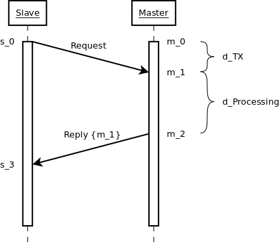

    here is a suggestion how to synchronize a slave to a master without the need of measuring anything. It's basically the same algorithm as NTP uses:
    In this example we have a master and a slave and we want to synchronize the slave clock to the master’s clock (radio timer RAT). Both clocks run with the same tick rate, but the slave clock has a certain initial offset T_0 relative to the master. Assuming that m_n and s_n specify absolute timestamps on the master and slave, respectively, we get the relationship:
    (1) s_n = m_n + T_0
    Initially, the slave doesn’t know T_0 and hence, m_n and s_n are different time domains. The following sequence diagram shows the synchronization process.
    The slave sends a synchronization request to the master and sets s_0 as an absolute start trigger for the TX command. After a short delay (RF frontend ramp-up), the RF core starts transmitting the preamble and the syncword. The time between firing the start trigger at the TX side and the receiver detects the syncword is named d_TX. It is a fixed value for a given RF configuration and could be measured. Here in this example, we measure it indirectly.
    The master receives the message and at the time m_1 = s_0 + d_TX (syncword found), it appends the receiver timestamp to the packet.
    After a short, predefined time d_Processing, the master responds to the request with a reply message. It sets the TX command start trigger to an absolute time m_2 and includes m_1 into the packet payload:
    (2) m_2 = m_1 + d_Processing
    When the client receives the reply at s_3, it has the following timing information and can calculate the initial clock offset T_0:
    • s_0: Request sent by the client
    • m_1: Request received by the master
    • s_3: Reply received by the client
    • d_Processing: A fixed delay for message processing on the master
    From (1), we know that:
    (3) T_0 = s_0 - m_0
    We don’t know m_0, but we know its offset to m_1 which is d_TX:
    (4) m_0 = m_1 - d_TX
    With (3) and (4) we get:
    (5) T_0 = s_0 - (m_1 - d_TX)
    We still don’t know d_TX, but we know that it is included into the round-trip time s_3 - s_0 as follows:
    (6) s_1 - s_0 = 2 * d_TX + d_Processing
    With the help of (6) we can rewrite (5) to:
    (7) T_0 = s_0 - (m_1 - (s_3 - s_0 - d_Processing) / 2)
    and finally obtain T_0. This value must now be added to any further RF operation on the client.
    All timing values are in the Radio Timer domain of the RF core.
    It is possible to optimize that approach: Since the offset d_TX depends only on the RF settings, it is sufficient to measure it only once during development. Then it can be compiled into the application and only one message sent by the master at is necessary to synchronize all slaves at once. Then the master could send (periodic) beacon messages and include its TX timestamp.

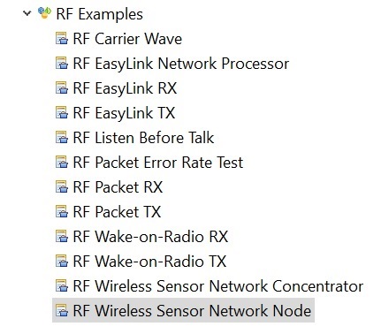

  • Hi Richard,
    Many thanks for so professional explanation. Make it simple, which project or command already has synchronization mechanism? Thanks.
  • Hi Daniel,
    we don't have an example for that, but you can merge the RF Packet RX and TX examples into one. Here are some example code snippets that show the essential parts. I didn't test though, yet, but it should work.
