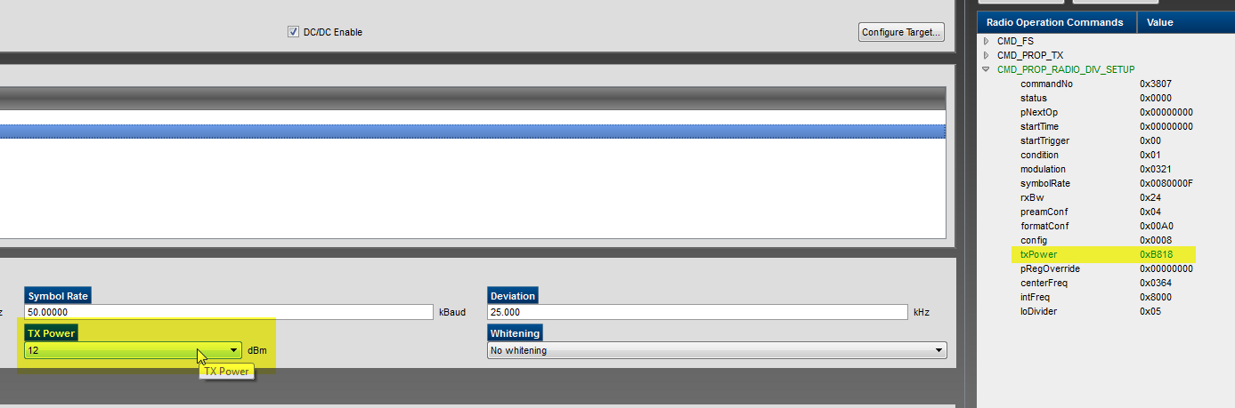

    are you using the GEN-FSK PHY in proprietary mode and do you want to update the PA output power dynamically in your application?
    The TX power can be updated using CMD_SET_TX_POWER. This is an immediate command. The TX power values are not generic and not always linear. We deduce them during PHY characterization and put the result into SmartRF Studio. I would suggest to use SmartRF Studio to get the values and put them into a look-up table, then use CMD_SET_TX_POWER to update the power.

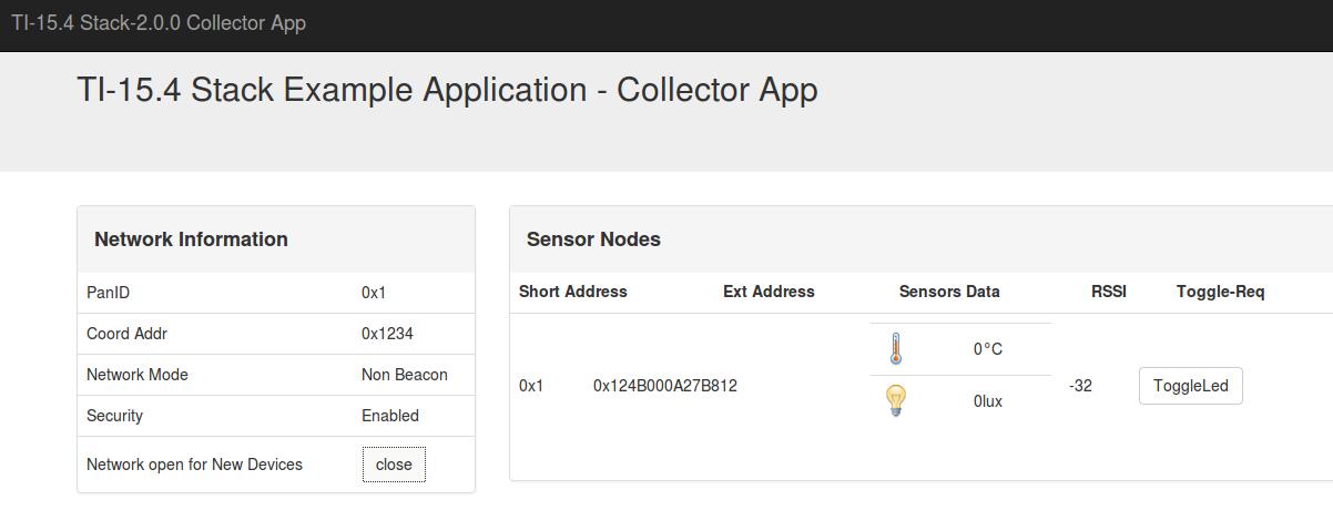

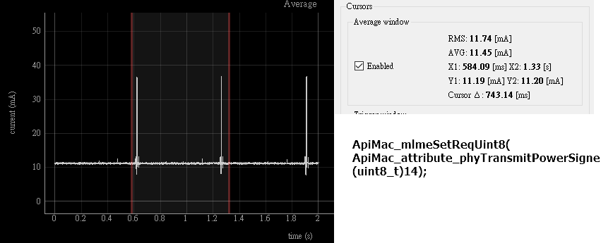

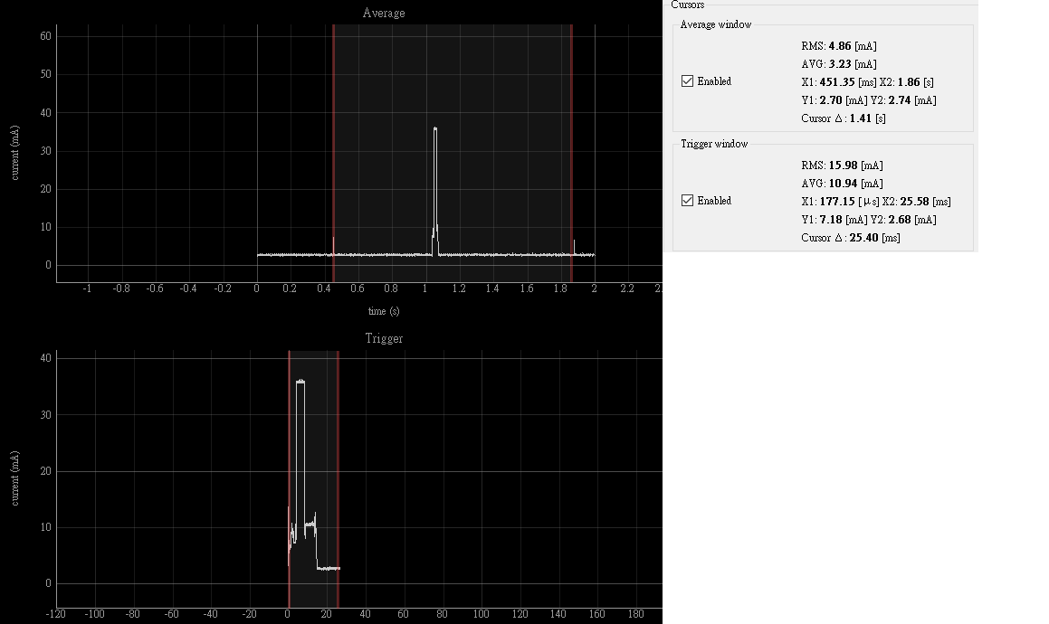

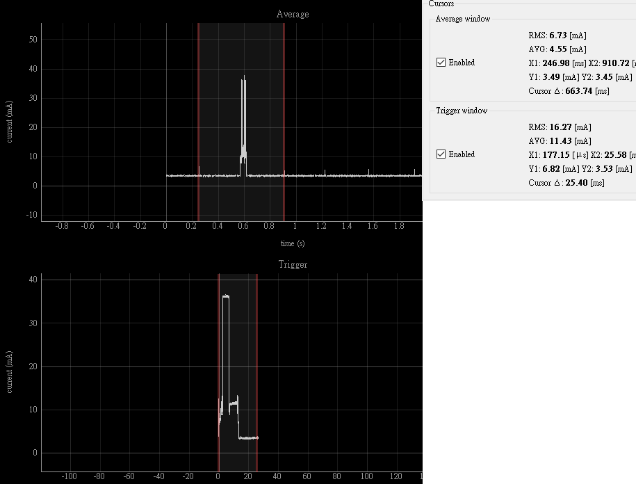

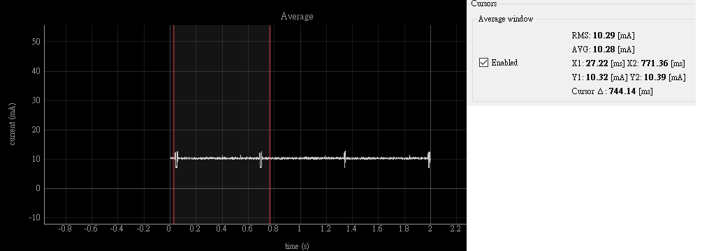

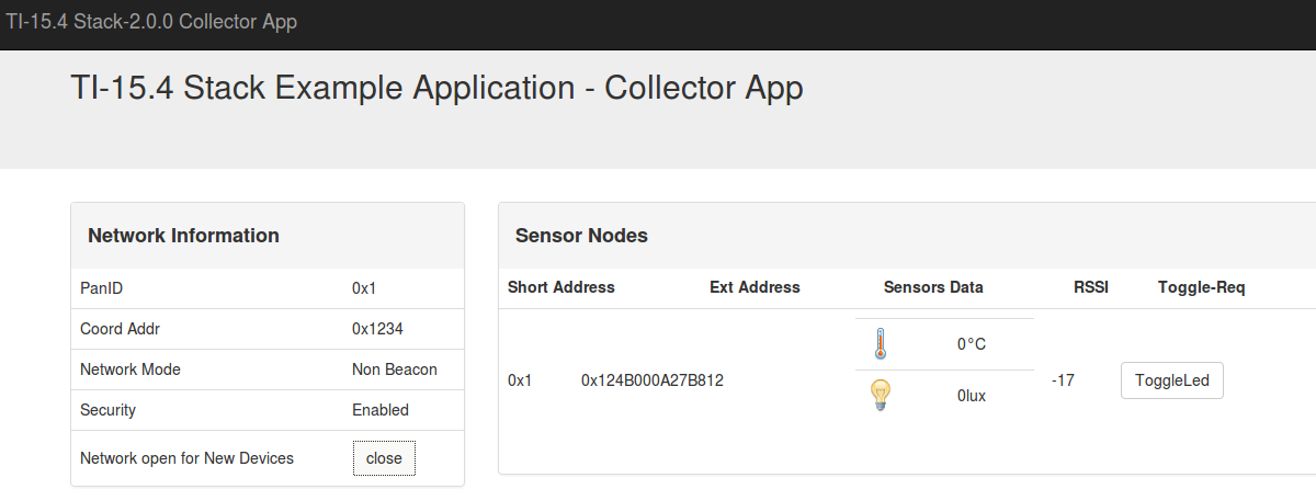

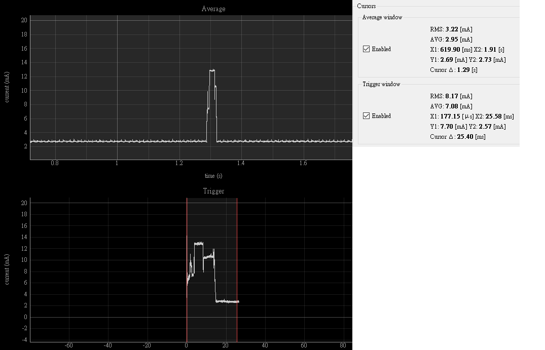

  • hi all and prashanth:
    update my test report.
    HW.CC1310 launchpad x2
    sdk:TI 15.4 Stack simplelink_cc13x0_sdk_1_00_00_13
    before Association(A, 14dbm ; B 0dbm)
    1.use key to change
            if(keys & KEY_RIGHT)
               ApiMac_mlmeSetReqUint8(ApiMac_attribute_phyTransmitPowerSigned,
                                       (uint8_t)0);
    After Association(C and D)
    2.by A,B case(use key to change TransmitPower,14 and 0 dbm)
       see image C.D
    As 1 and 2, the result is same. so,it seem that not valid.
    3. E
    change preprocessor define macPibDefaults ,the phyTransmitPower = 0(14)
    at the same test case,the web application show the rssi value lower than other.
    so ,it is preprocessor define ,i can't change at run time redefine .
    I hope you will be able to provide the information.
    A.before Association( 14dbm)
    B. before Association(0dbm)
    C.after Association(14dbm)
    D.after Association(0dbm)
    E. macPibDefaults =phyTransmitPower
