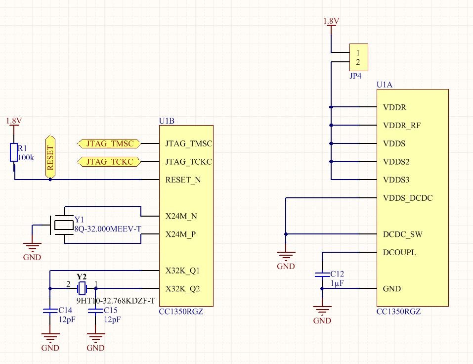

Hi
I want to use a CC1350 on a custom PCB. Since I need a 1.8V power source for other components I use a TPS62740 to generate board wide 1.8V.
To save power I want to use this voltage directly for the CC1350. So I designed the PCB with the CC1350 in External Regulator Mode like describes here (www.ti.com/.../swra498.pdf) and in the technical reference manual to disable the integrated DCDC.
All Vdd pins are connected to the 1.8V output of the TPS62740 except VDDS_DCDC which is (together with DCDC_SW) tied to ground.
In addition I connected a 24MHz and 32kHz crystal.
For programming I connected the TSMC, TCKC and RESET pin to the equivalent pins on the XDS110 of a CC1350 Launchpad. RESET has a 100k pull up resistor to 1.8V. The signals from the Launchpad are changed to 1.8V via a level shifter
Thermal pad is grounded. All other pins are unconnected and floating.
Unfortunately with this setup access to the CC1350 via smartRF studio and CCS is not possible.
I either get the error message "Device access failed: XBAL: Target connect failed" (smartRF) or "Error -242 @ 0x0, A router subpath could not be accessed." (CCS).
Does anyone know how to fix this issue?

    Below the part of the schematic with the CC1350. All DIO* pins are connected to various GPIO devices which are currently not populated on the PCB. So all DIO* pins are floating

  • A question about the xtal: If you have used a 24 MHz xtal, why is it named 32.00?
  • Neither CCS, nor SmartRF, nor FlashProgrammer 2 recognize my CC1350. Error message from Flash Programmer is: Create XBAL object failed: Target connect failed Failed to create device object.
    In the schematics I used a device we have in our local component library that has 32MHz. On the PCB I used a 24MHz xtal from the same series with the same footprint. So this is just a typo I forgot to fix in the schematic. Sorry for the confusion.

  • It seems 8Q-32.000MEV-T is a 32M crystal. You should use a 24M crystal instead of 32M.
  • Sorry about that confusion. TER mentioned the same thing earlier. This is just a typo in the schmeatic. We had the 32MHz version in our component library so I used that and forgot to change the name. On my PCB I soldered a 24MHz with same footprint from the same series.

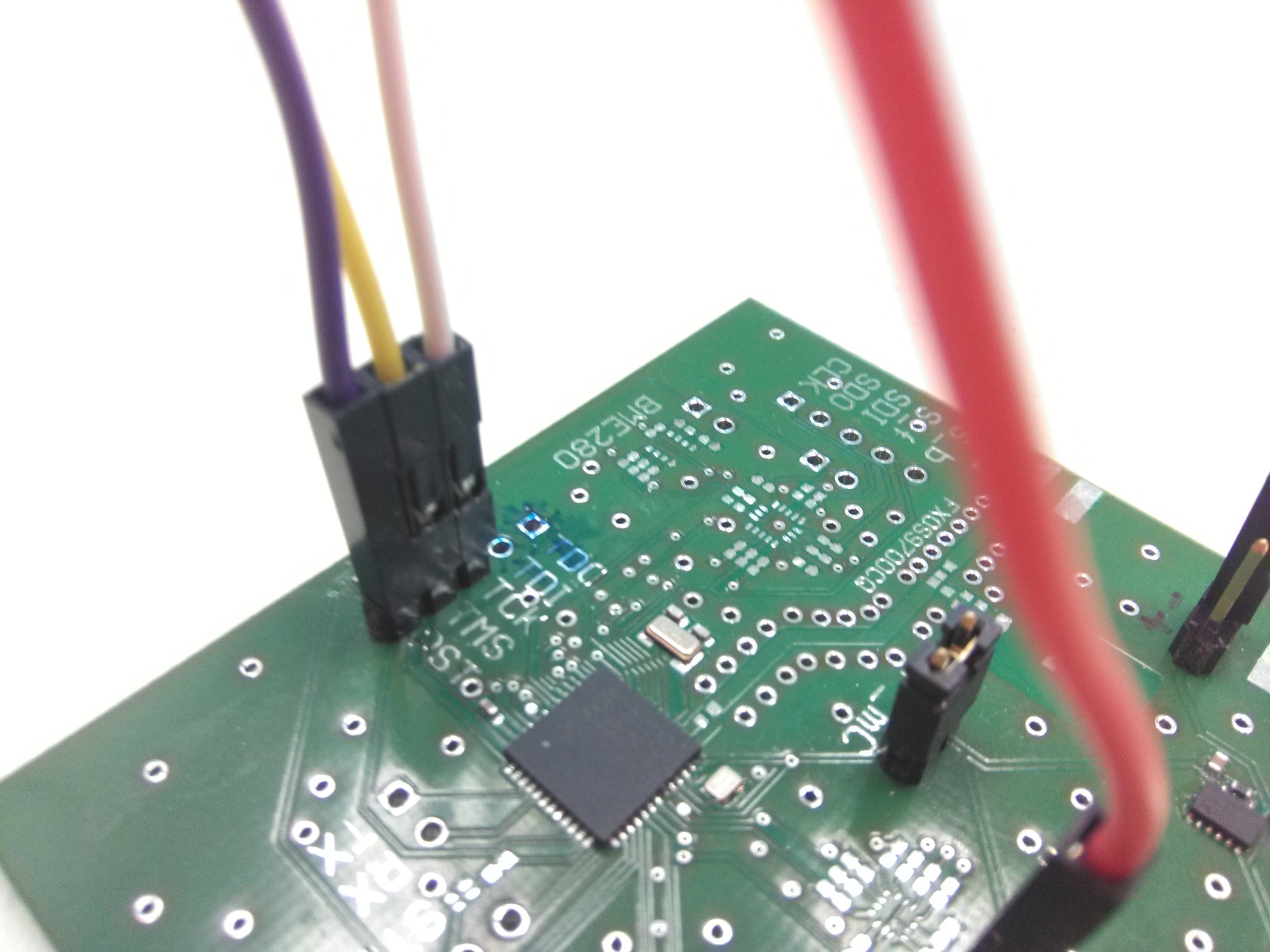

  • From your description I can't see why it shouldn't work. Is it possible for you to take some pictures clearly showing how you have connected your PCB and the LP together?
  • I hope the pictures are clear enough.
    On my PCB I have connected TCK; TMS; RST
    TMS is connected to the pin 24, TCK to pin 25 and RST to pin 35.
    Other than that I only have the 24MHz xtal at pin 46 and 47 and the 32kHz xtal at pin 4 and 5.
    To make the 3.3V from the LP compatible I used a level shifter for TMS and TCK. RST is directly connected.
    If I check the signals on either side of the level shifter (on the LP and my PCB) they are the same, just have different voltage.
    So the levelshifter itself should work ok.
