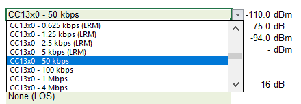

Has there been an update to the preliminary App-Note "Wide-Band Long Range Mode (LRM) on CC1310" from May 2016?
Also, when employing the Wide Band LRM (DSSS), what value to select for Richard Wallace's Range Estimation for Indoor and Outdoor Rev1_17.xlsm?
From the preliminary data sheet, this looks like -106.8dBm?
Peace,

    Sensitivity at 62.5Kbps datarate(500kbps symbol rate) is -106.5dBm and this can be used for rnage estimation. There have been some minor updated to the App note to update information for Rev B version of CC1310 and to reflect the names of patches that are released in SDK for this mode. Please find the relevant information below:
