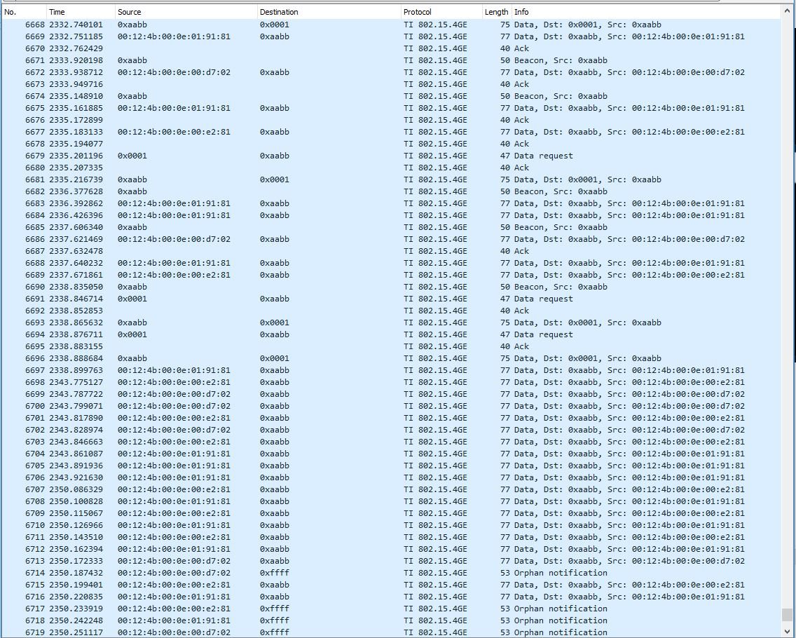

I am implementing a star based beacon enabled network using four cc1350 launchpads ( I am using a CC1310 as a collector. But i think its not an issue. I have only changed the beacon order and super frame order). I expect to increase the number of sensors to more than 100 in near future. Currently I am using collector and sensor examples to test the network where beacon order is 6 and supper-frame order is 2. Sensors are configured to send data using their extended address. This is what i got on console for three sensors and the coordinator.

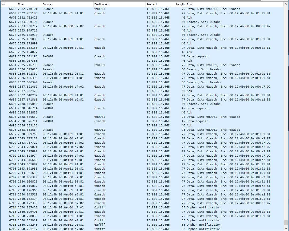

Here is the data I tracked using wireshark.

    It looks like tx operations are being aborted on your sensor devices (error code 0x1D). Does the collector stop sending beacons when no devices join the network?

    First of all, thanks for your reply. All three sensors are connected to the collector. These sensors send data on every second. Yes as you said, some of the tx operations are aborted but most of them are transmitted. Even the sensor data doesn't transmit, there is no reasons to stop beacons. As you can see in the wireshark log, sensors are connected and transmit data. But suddenly beacons get stopped. I have uploaded my source code and projects. If you have a time to look at it, it will be much appreciated. I suspect this happens from the stack. I don't get API MAC callbacks indicating any errors.

    We have identified the issue and it can be fixed with a library update. Please use the attached library https://e2e.ti.com/cfs-file/__key/communityserver-discussions-components-files/156/7028.maclib_5F00_secure.a
    This issue will be patched in the next release coming in a month or so.
