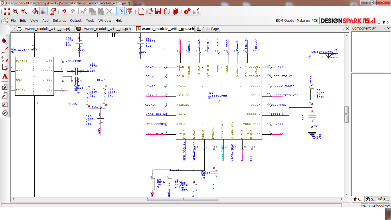

Hi everyone,
We are trying to jump from CC1350 Launchpad to our custom board and burn the BLE stack. When we do it through the Launchpad we could detect the BLE advertising.
However, when we redirected the same TCK, TMS, Reset, 3v3 and GND pins to our board and burn, Code Composer reaches the same reset state at the end but unfortunately we could not get the BLE radio up
on our board. The only difference between our board and the eval board is the package; we have 5mm RHB while the chip on eval board is 7mm RGZ. Would anyone guess what might have gone wrong?
They have the same amount of flash 128KB. Do we have to do anything specific on the Code Composer Studio while burning to an external 1350 chip?
Thanks ahead
Ahmet

  • I assume you have changed the board file to reflex that you use a 5x5 and not 7x7?
    I can take a quick look at your schematic if you want (you can send me a friend request and send it that way)
  • Hi TER, this is great clue; I was curious how to refer to 5mmx5mm package in the CCS. Can you please guide us in that, we have been looking at the menus in CCS to see if we could pick such a setup but no luck.
    Also I am attaching the snapshot of the schematic here, everything is quite matched with the TI eval board BOM, as you see though in the schematic we are using only routing out JTAG pins and nreset without TDI and TDO. But the JTAG interface seemed fine while connecting with RFStudio, so the problem of loading the BLE stack should be specifying the 5mmx5mm option based on your feedback, but we could not locate that menu in CCS.

  • You basically have to modify the board files to reflect the 5x5/ your pinout as described in the link I posted in my last reply.
