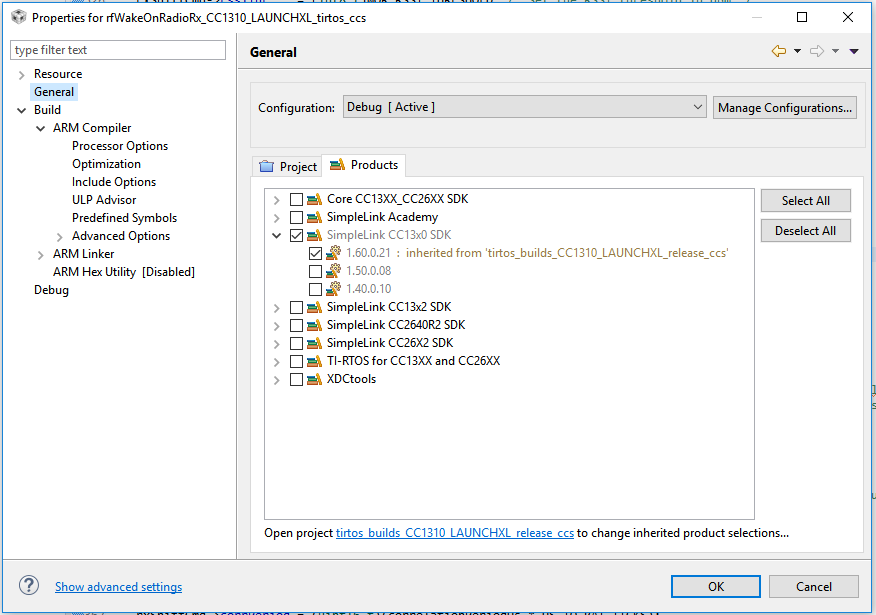

  • If you look at TI-RTOS 2.20/ 2.21 the OS project and the application files are in the same project. For the new SDKs, the TI-RTOS related files are a different project linked in.
    If you look at the smartrf files from the SDK 1.5 you will see that the #include section is made differently. If you haven't done any porting I suspect that you still are using most files from the old TI-RTOS version but are trying to find them in the new SDK. Without knowing anything about your project it's difficult to be more detailed. Ensure that only one TI-RTOS product is selected in the dialog below.
