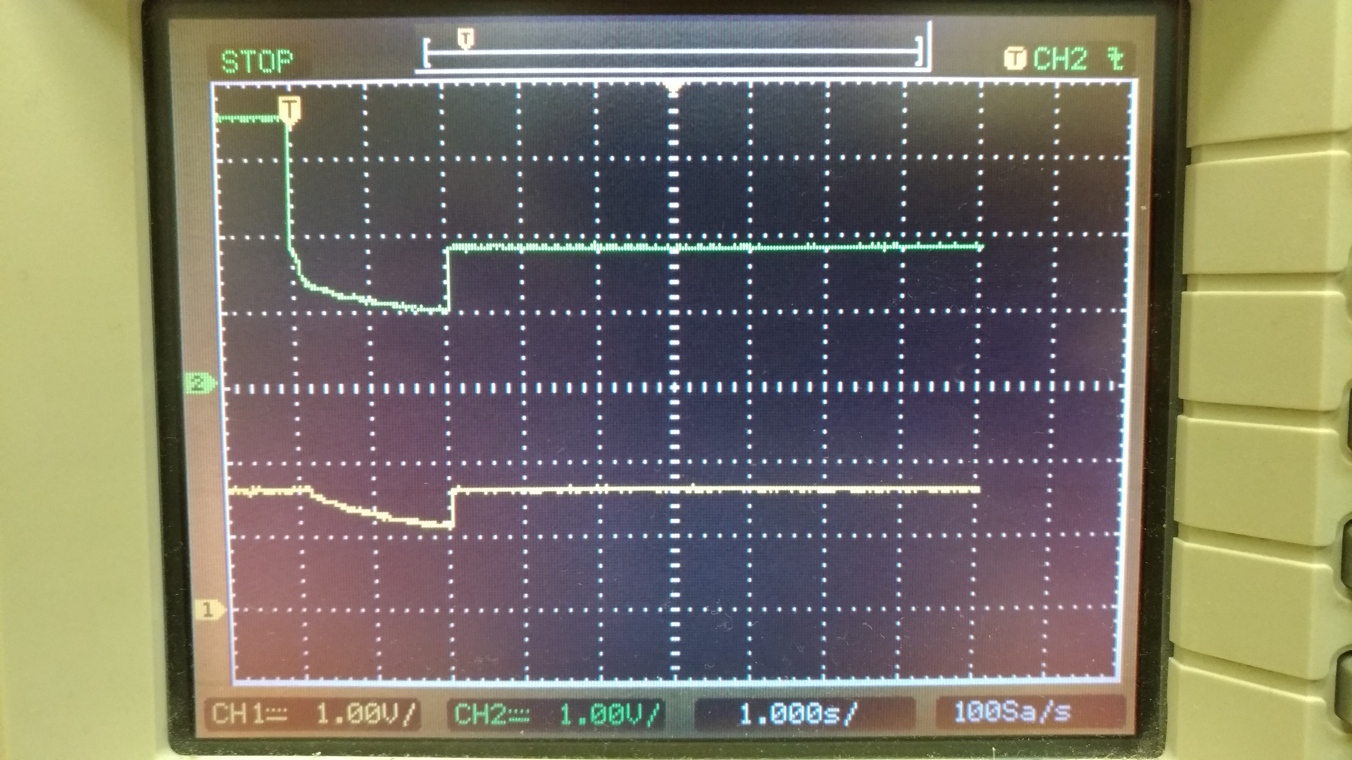

  • Would you be able to measure the VDDS and VDDR lines showing the levels when you take out the battery and insert it again?
  • Attached is an image with VDDS (CH2-green) and VDDR (CH1-yellow). Both 1V/div. Note that I wait for 2 secs to re-insert the battery.
  • Ivan,
    Brown out reset (BOD) is factory trimmed to right below 1.8V. This is not programmable beyond that it can be increased to 2.0V when using the 14dBm radio "boost" mode, where VDDR is also increased to 1.95V.
    There is also a power-on-reset (POR) module which triggers between typically 1.0V - 1.4V.
    Below POR threshold, the system current draw is in the low 100s of nanoamps.
    Between POR and BOD thresholds, the current draw is around 80uA.
    Above BOD threshold, the system boots. Initial power-on (to charge VDDR and DCOUPL capacitors to nominal voltage) is around 25mA. After this, the device boots and draws its normal active current draw.
    This information should really be in the data sheet.
    The failure mechanism you explain, drawing 100mA after power-on, causes the TPS to not supply enough current. Interestingly, this happens around VDDS = 1.8V which is when the CC1310 boots.
    However, the cause of the current draw might also be elsewhere. I suggest you try to isolate the problem by de-soldering anything connected to the GPIOs of the CC1310, chip by chip. 100mA might also be enough to be able to pinpoint the current draw by putting your (ESD protected) finger on the chips on the board to see which one is hot.
    Svend
