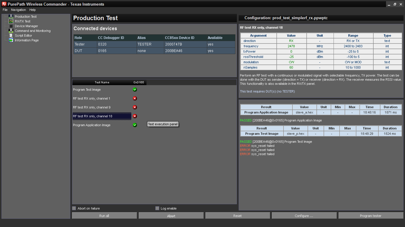

Error "sys_reset failed" using PurePath Wireless Commander
I am trying to run some RF tests using the Wireless Commander.
When I try any of the default example tests included in the config folder I get an error message saying "sys_reset failed".
I manage to define the tester, load the tester firmware to the tester board and load the test and application firmware to the DUT boards. It is only the RF test stages in the test routine that fail. Furthermore, when I try to get chip or device info in the Device Manager i also get an error message telling there is a communication failure. Please see the attached screenshots below.
Does anybody have an idea why this happens?

    I am only using hardware from the development kit. I am using the default configurations contained in the "config" folder, and the associated test images.
    Both PurePath boards are working perfectly when programmed using the PurePath Wireless Configurator. It is only when I try to run the tests in PurePath Wireless Commander that I get this unexpected behavior.

    I have tried to forceing this behavior using my hardware but I have not been able to do so.
    Can you run the SYS_RESET() command from the "Command and Monitoring" panel successfully?

    First, concerning your question: I'm not sure if I can run the SYS_RESET() command successfully from the "Command and Monitoring" panel. I don't get any error message when typing it and clicking run. But I don't know if the command is executed, because nothing happens. For the record, I can also type any other, random word, for example DALAHEST(), and I get exactly the same behavior: nothing happens and I get no error message. So I really don't know...
    But I have some new information. The tests actually worked fine for a good while this morning. The problem seems to be intermittent. Sometimes it works, sometimes not. The symptoms are often different. Sometimes one of the debuggers are marked as "not available", sometimes it seems to be available but does not respond (blink) to the "identify" function, sometimes the "get device ID" function does not work, and sometimes it does. When I first posted my question I did not manage to run the tests at all, but today it sometimes works.
    Do you think the problem could be USB/PC or debugger related? I run the latest version of the PurePath Wireless Commander software (version 1.0.0 - Build ID 36940). There has been only one release of this software, hasn't it? I'm running it on a Windows XP SP3 computer.
    Thank you for your help.
    Torje
    Yes, now it really sounds like a HW issue. Very hard to say where to find the root cause. The version of commander you have is the latest one.
    To test the sys_reset() command, you can e.g. have a link up and running. Then its easy to see if the device resets.
    DALAHEST() should give you the response "Script execution failed ..." in commander.
