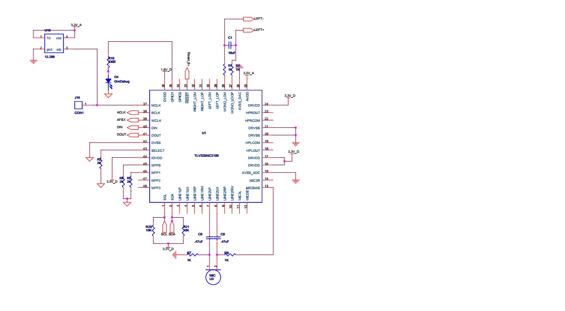

I am trying to read I2S data from TLV320AIC3106 audio codec with a condenser mic connected to left channel.
Below given is my codec settings which is successfully written to the codec that I could read back the registers using I2C.

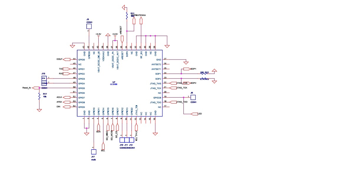

    This is the connection I am using.

  • Hi Vincent,
    I am not using RTOS as of now. All I am trying to do is reading I2S data out from the audio codec. I can see signals on I2S bitclock, I2S word clock and I2S data line using an oscilloscope. That means initialization of I2S module seems to be okay. Problem may lies with I2S handler initialization and reading data routine. Are my pinmux configuration correct? Is there anything wrong with I2S data line configuration?
