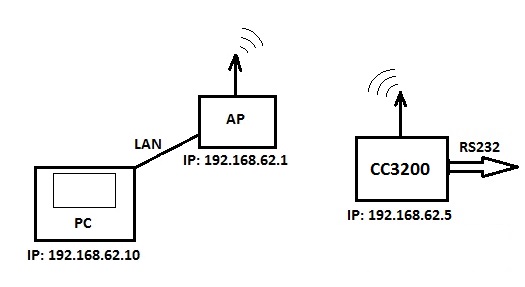

    If it's possible to establish connection according this picture:
     My general question is: is it necessarily to flash this certificates in CC3200, to connect CC3200  to the PC (as shown in the picture above). If the response is YES - if it's possible to get my goal if I only follow the steps in serial_wifi document? If the connection isn't secured, is it necessarily to flash this certificates? Which example from CC3200 SDK is related to unsecured connection between server and client?
    Thanks regards,
    Sergey!
  • Hi Sergey,
    Certificates are only required for establishing a secured SSL connection. even that is not a must, but then you are hurting your level of security.
    The serial WiFi example is assuming that the two sides are using CC3200, so, you will need to take the code used in the example and compile it on your PC.
    As Prathyusha wrote, you can just comment out the SECURE_SOCKETS define in order to use unsecured sockets.
    Alon
