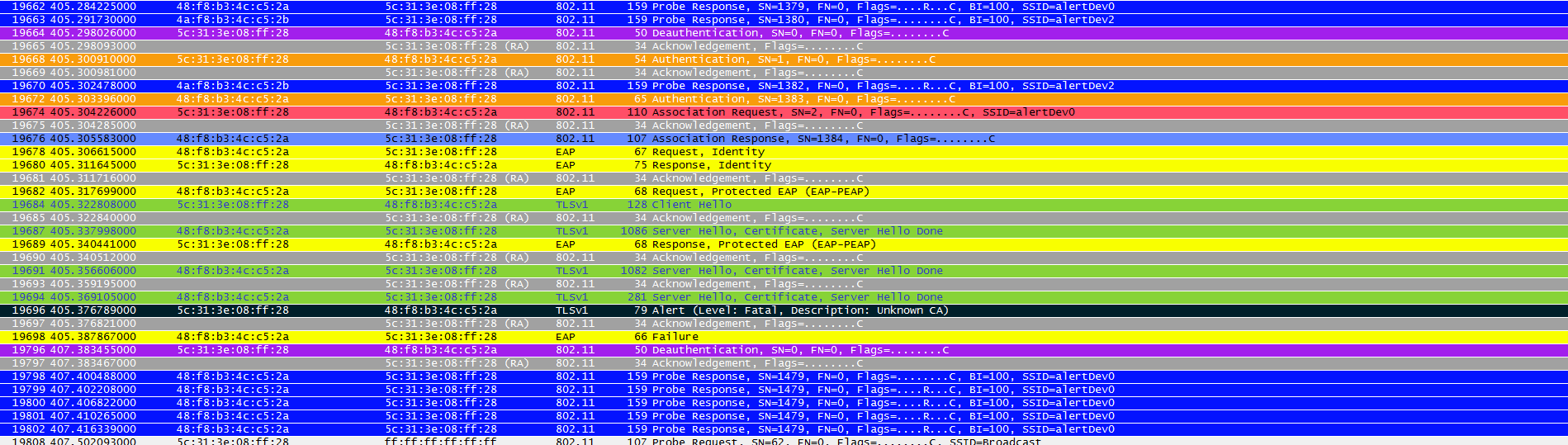

  • Hi Alon,
    Thank you for the update. Unfortunately, it's still not working for me. I'm using the CC3200 Launchpad Rev4.1. After updating the service pack, I uploaded the dummy cert:
    [11:46:53] INFO: > File name: /cert/ca.pem, Update: true, Erase: true
    [11:46:53] INFO: > Erase File: /cert/ca.pem
    [11:46:53] INFO: erasing file "/cert/ca.pem"
    [11:46:53] INFO: deleting file "/cert/ca.pem"
    [11:46:54] INFO: erase file completed
    [11:46:54] INFO: > Size of file = 1310
    [11:46:54] INFO: > Update File: /cert/ca.pem
    [11:46:54] INFO: Downloading file "/cert/ca.pem" with size 1310
    [11:46:54] INFO: New Token is 0x0
    [11:46:54] INFO: Download complete
    [11:46:54] INFO: > Updated Token value: 0x0
    Then I built and ran the ent_wlan example from sdk1.1.0 with the addition of the codes from the release note:
     //start ent wlan connection
        eapParams.EapMethod = SL_ENT_EAP_METHOD_PEAP0_MSCHAPv2;
        eapParams.User = USER_NAME;
        eapParams.UserLen = strlen((const char *)eapParams.User);
        eapParams.AnonUserLen = 0;
        g_SecParams.Key = PASSWORD;
        g_SecParams.KeyLen = strlen((const char *)g_SecParams.Key);
        g_SecParams.Type = SL_SEC_TYPE_WPA_ENT;
        // disable server authentication
    	unsigned char pValues;
    	pValues = 0;  //0 - Disable the server authentication | 1 - Enable (this is the default)
    	sl_WlanSet(SL_WLAN_CFG_GENERAL_PARAM_ID,19,1,&pValues);
        lRetVal = sl_WlanConnect(ENT_NAME,strlen(ENT_NAME),NULL,&g_SecParams, \
                                     &eapParams);
        UART_PRINT("sl_WlanConnect returns: ");
    //    UART_PRINT(lRetVal);
        UART_PRINT("%d \r\n", lRetVal);
        ASSERT_ON_ERROR(lRetVal);
        // Wait for WLAN Event
        while((!IS_CONNECTED(g_ulStatus)) || (!IS_IP_ACQUIRED(g_ulStatus)))
            // Toggle LEDs to Indicate Connection Progress
            _SlNonOsMainLoopTask();
            MAP_UtilsDelay(8000000);
            GPIO_IF_LedOn(MCU_RED_LED_GPIO);
            GPIO_IF_LedOff(MCU_RED_LED_GPIO);
        GPIO_IF_LedOn(MCU_IP_ALLOC_IND);
    The console output is as below:
    Host Driver Version: 1.0.0.10
    Build Version 2.5.99.2.31.1.4.0.1.1.0.3.34
    Device is configured in default state
    Device started as STATION
    sl_WlanConnect returns: 0
    [WLAN ERROR]Device disconnected from the AP AP: ,BSSID: 0:0:0:0:0:0 on an ERROR..!!
    Here is the wireshark trace:
