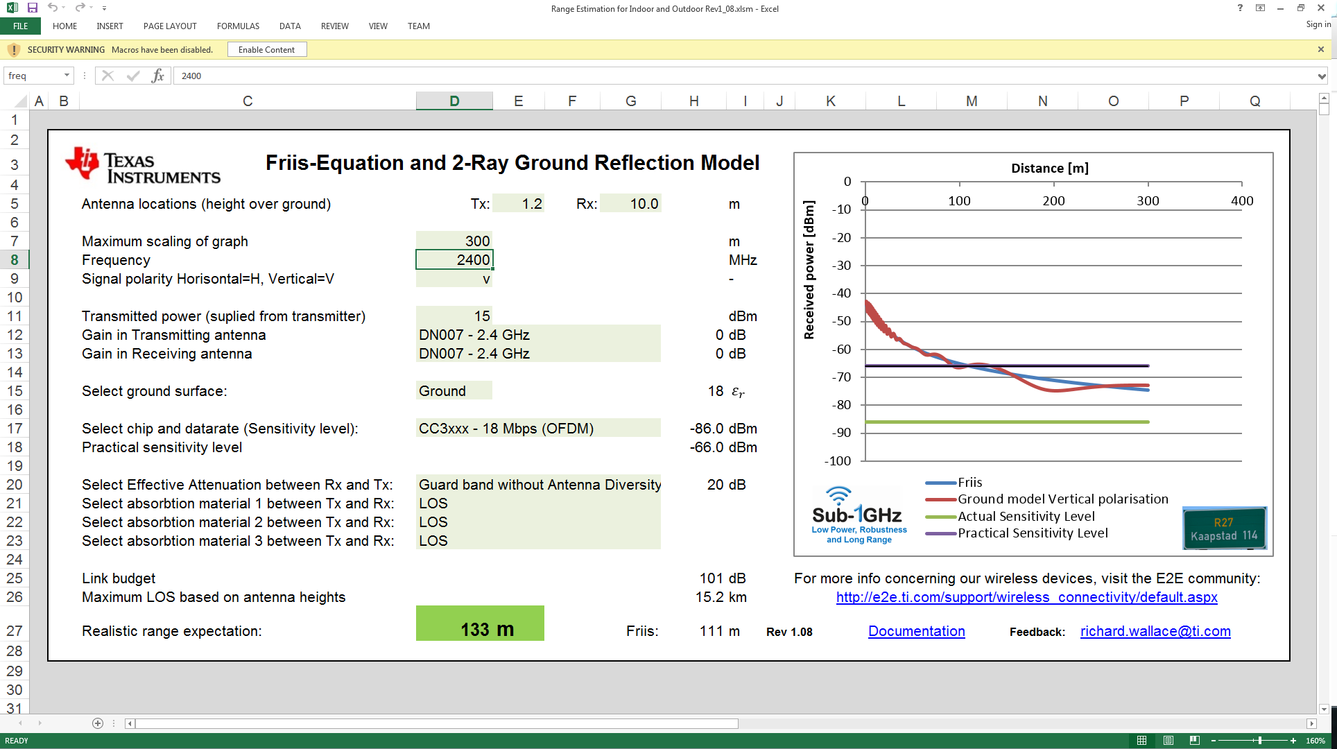

The attached excel sheet helps to estimate a practical range estimation for indoor and outdoor radio links.
The outdoor is based upon Line-of-Sight (LOS). For the indoor estimation, construction materials can be selected that are between the Tx and Rx unit. The greater the attenuation of the combined material between the Tx and Rx unit, the shorter the distance.
This has been used a lot in TI seminars and is a helpful tool for calculating a realistic and conservative range expectation.
CC2564x and CC31xx/CC32xx has been added to the drop down list for devices.
Any feedback is welcomed.
Regards, RichardRange Estimation for Indoor and Outdoor Rev1_08.xlsm
