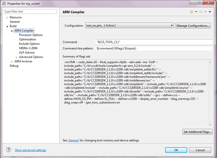

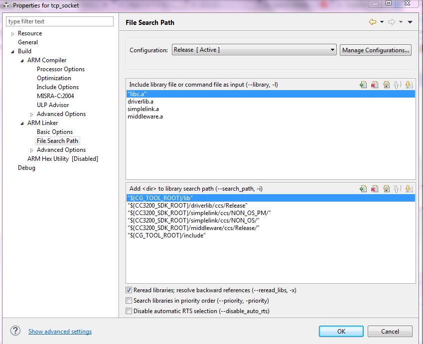

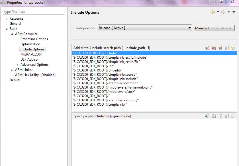

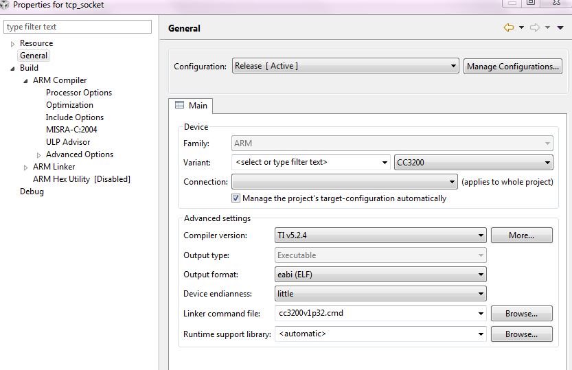

  • hello
    please try to add LPDS capabilities to the tcp socket, this is what caused the problem, and when i remove the linking (middleware etc) it works
    i am attaching the modifications i did and screenshots of the linking

    Can you please make sure simplelink non os PM compiled without DISABLE_DEBUGGER_RECONNECT options.
    Aashish
  •  in what configuration are you using?
    i did not change it from what is defaulte when i loaded the tcp socket example
    maybe that is the problem?
    do i need to change it to non_os_pm ?
    please advise,
    do i need to change the config to simplelink->non_os_pm or can you just tell me what configuration to change in the tcp_socket example
    roi
  • Hi Roi,
    1. Recompile simplelink as Ankur suggested on e2e.ti.com/.../1577461
    2. Now goto project properties of tcp_client
    3. Select ARM Compiler->Include Options and add following lines in include search path:
    "${CC3200_SDK_ROOT}/simplelink_extlib/flc/"
    "${CC3200_SDK_ROOT}/simplelink_extlib/include/"
    "${CC3200_SDK_ROOT}/middleware/framework/pm"
    "${CC3200_SDK_ROOT}/middleware/soc"
    4. Select ARM Linker -> File Search Path and delete below line in library search path
    "${CC3200_SDK_ROOT}/simplelink/ccs/NON_OS/"
    5. And add below lines in library search path
    "${CC3200_SDK_ROOT}/simplelink/ccs/NON_OS_PM/"
    "${CC3200_SDK_ROOT}/middleware/ccs/Release/"
    6. Add below line in Include library file
    "middleware.a"
    Aashish

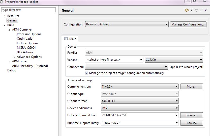

  • hi
    as you can see in the pics i attached, all of the configuration you mentioned i have already done, i duplicated all the configuration from the non os pm configuration but it is still not working
    a different thing that i tried is in the manage configuration i did a new configuration and imported the non_os_pm from project "idle_profile_non_os"
    when i tried to change the configuration to non_os_pm i did not see that i have a linker tab as you can see in the pic below
