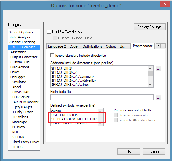

Hi everyone,
I'm starting with the RTOS and the CC3200, so I'm working on the FreeRTOS example and the TCP socket example, I'm trying to combinate both of them, in one task I'll have the TCP functions and in another one I'll have the communication with the UART, untill now I'm having a problem connecting the CC3200 with the AP and after reading a lot of posts I see that is because I need an Asynchronous Event Handler, but is not clear for me how I can implement that, so if you could explain it to me or tell me where is the information to do it I'll be very thankful.
The part of the code where I'm getting stuck is:
/* Wait */
    while((!IS_CONNECTED(g_ulStatus)) || (!IS_IP_ACQUIRED(g_ulStatus)))
        // Wait for WLAN Event
#ifndef SL_PLATFORM_MULTI_THREADED
        _SlNonOsMainLoopTask();
#endif
Is in the part of the funciton WlanConnect()

  • Hi Victor
    I've been readign a little bit more and I solve my problem by myself, I found that if you are using a RTOS you just can simply ignored _SlNonOsMainLoopTask(), if that fuction is there is because the example is configured to not use RTOS and if you want to use it you have to make a few thinks.
    In my case I use IAR and you have to do this settings in the options of the project:
    1. In the preprocessor part in C/C++ Compiler I had to write the two defines in the red square.
    2. Then in the Linker option I had to put the direction of the simplelink library made for OS and the RTOS to use
    3. Finally in the code I had to put these lines in the main before call any of the simplelink functions
    lRetVal = VStartSimpleLinkSpawnTask(SPAWN_TASK_PRIORITY);
        if(lRetVal < 0)
            ERR_PRINT(lRetVal);
            LOOP_FOREVER();
    This create a Task that will take care of the asynchronous events
    With this I solve my problem and the CC3200 finally conects to the AP.
