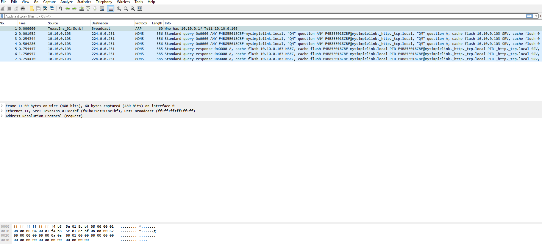

    I'm debugging now with Wireshark and attached request from my CC3200 do somebody can clarify is there method to resolve local addres or is there any alternative to make it possible resolve somehow host name addresses by name? Maybe install on host machine not avahi?

  • well, I'm deeply dig into wireshark logs and seems mDNS is not supported at all.
    In code I use
    #define SERVER_NAME "mnc.local"
    iretvalmDNS = sl_NetAppDnsGetHostByName( SERVER_NAME,strlen(SERVER_NAME),&pAddr,SL_AF_INET);
    as in real request is ANY, and more over simple link response byitself on its own request, what is going on why simpleling does not request SERVER_NAME in real ethernaet packet? I'm requesting TI how can I tune simplelink to request my avahi mDNS?
