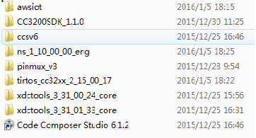

  I'm trying to get the aws iot embedded c sdk example subscribe_publish_sample going. I've got all the build settings done as listed in https://git.ti.com/iotdev/awsiot/blobs/master/README_CC3200.md
below picture point the install directory
