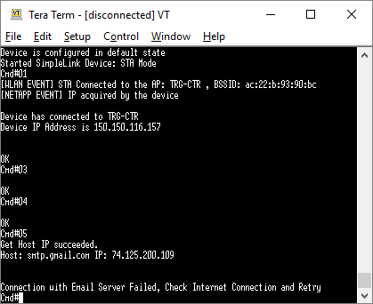

Hi guys, I'm working on the email example, it seems that on my end, I'm not able to send the email due to the following error :
Connection with Email Server Failed, Check Internet Connection and Retry
I did some google search and found out these :
I have tried all of the solutions in these 3 links and the WIki for email example, but the outcome is still the same. I have change the sender and receipent email in demo_config.h as well. All of the jumper are as in the wiki page. Pretty please guide me to solve this. thanks in advance.

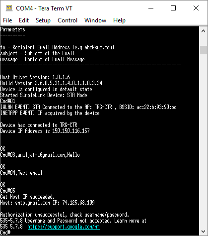

  • So after tweaking the the connection's security type, the previous error no longer show up. But now I'm facing a new one as shown in the picture below :
    I've change the macros inside the demo_config.h as needed, shown below

    but still the terminal gave me "Authorization unsuccessful, check username/password.". Can anyone guide me where i've done wrong please.
  • Hi looks like I'm now able to run the email sdk without error. Here's some of the silly mistake i make that causing the errors.
    First in the demo config, remove the angle brackel "<>" from USER, USER_RFC, PASS and RCPT_RFC.

  • Hi Harsha,
    I was having very similar problems to what you are describing above. Followed all the helpful advice from Azwir and the links provided in the first message, other related posts on E2E, and was still not having success! I had even had the demo working previously a few months back and could not figure out what I changed.
    When re-checking the Gmail smtp settings (for the 10th time...) I went to the SSL link under the Gmail SMTP server column and read the note in the last paragraph of the SSL connections overview page which indicates Google Apps is superseding SSL with TLS. At first I didn't think anything of this, but out of curiosity I tried to use TLS instead of SSL and it worked! Same port (465), host name, with the only change made in main.c to the Case 05 routine for SecurityMethod and SecurityCypher. My changes are below.
    eMailServerSetting.SecurityMethod = SL_SO_SEC_METHOD_TLSV1_2;
    eMailServerSetting.SecurityCypher = SL_SEC_MASK_TLS_RSA_WITH_AES_256_CBC_SHA;
    Might be worth a try! As an intriguing side note the TLS required port, 587, did not work for me, but your mileage may vary.
